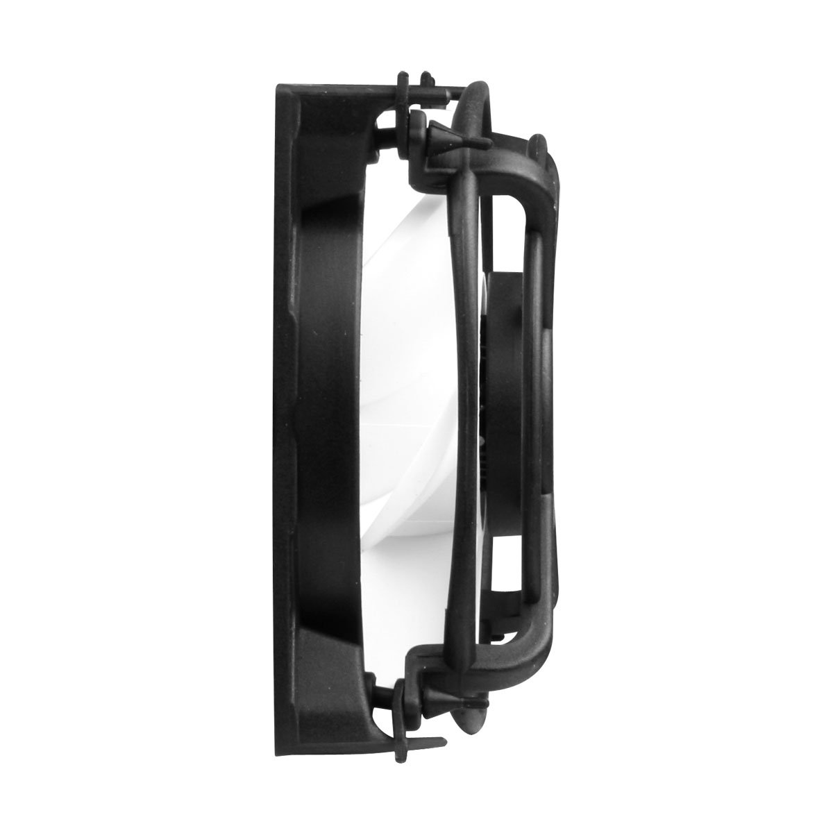

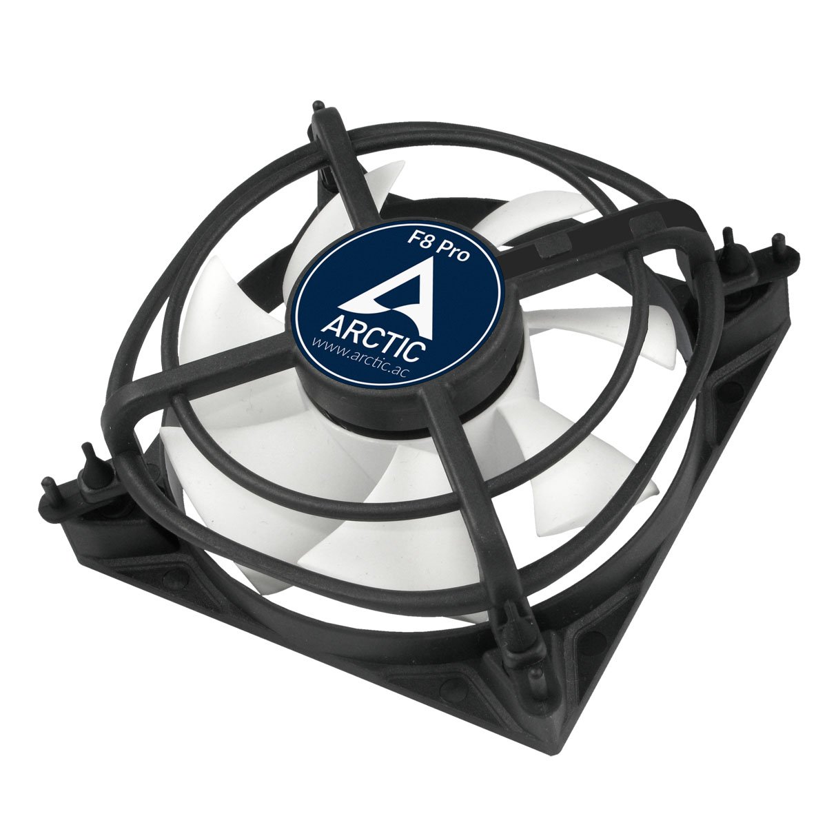

1 hour ago, KPopOG said:
But, I also made the mistake of buying fans that can only be mounted one way. It makes sense that my most powerful 80mm should be on the side panel, drawing air directly to the CPU, pushing it out to the 120mm on the back. But, it only works with intake!!! Unless I want to mount it on the outside of the case, which means the motor sticks out an inch or so. Don't know quite yet, but probably going with closed.
These some super cheap fans with holes only on one side? Gotta pic?
Yeah... except their marketed as the "Pro" version by Arctic. I mean less vibration according to them, but I'd rather choose whether I want intake or exhaust fans.
Thought I added a pic there, but here you go. There's no way to mount the motor to the other side of the box either, there are no holes to fit it.
Looks like you could remove grill/brace and anti-vibration mounts. Then it's just like any other fan. I've only seen this design in top-down cooler fans before, even Arctic has since realized how bad this design is for wider audience. Shows how old design it is when fan has molex along with PWM.
Molex and PWM? Ew...
The motor is actually part of the anti-vibration brace though. You can't remount it on the other side of the box either.
