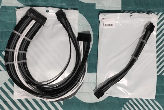

18 minutes ago, Caroline said:
Here are some example China cables if you're interested, there's a kit and also individual cables
https://winkool.aliexpress.com/store/907279
Yeah their not bad, look better than these ones. However the reason I ponied up the money was the get the proper lengths as this build is SFF, super compact.
The sf750 comes with braided cables already as well but it's way to much excess wire, like double and triple the length I needed . I didn't want all that clutter after working through all trouble of making... Forcing hardline water cooling with borosilicate glass tubing to work.
