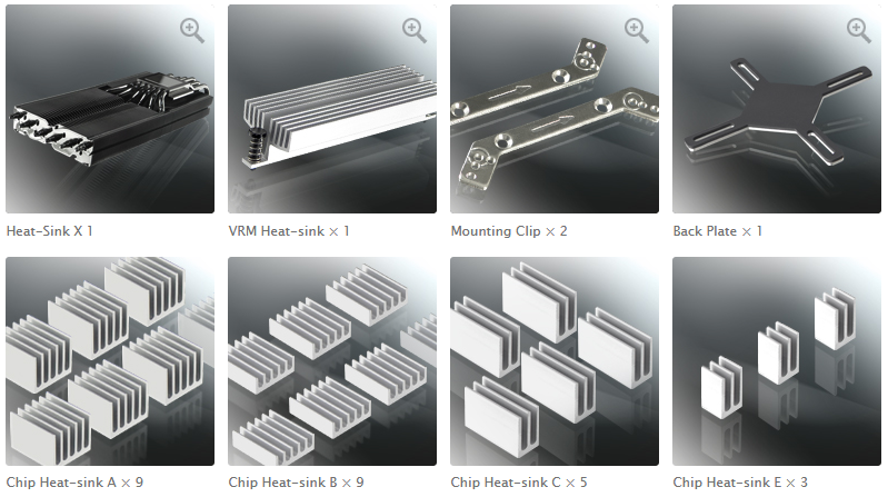

I know Raijintek Morpheus II can fit, but you're not having any other PCIe expansion cards after installing that (3 slots just with the heatsink, more with fans)
Thanks for suggestion. Looks like that would only cool the core area, not other things?
Seeing if I can find any water blocks that fit it at moment, might have found one but need to check my exact model to be sure.
I believe the cooler comes with individual heatsinks you place on memory modules and the mosfets/chokes, much like you'd put thermalpads on them for a water block.

32 minutes ago, porina said:
not other things?
Comes with several heatsinks
https://i.gyazo.com/a0cf65cd2c5a8f9f1556d7fcfe8a3cb5.png
