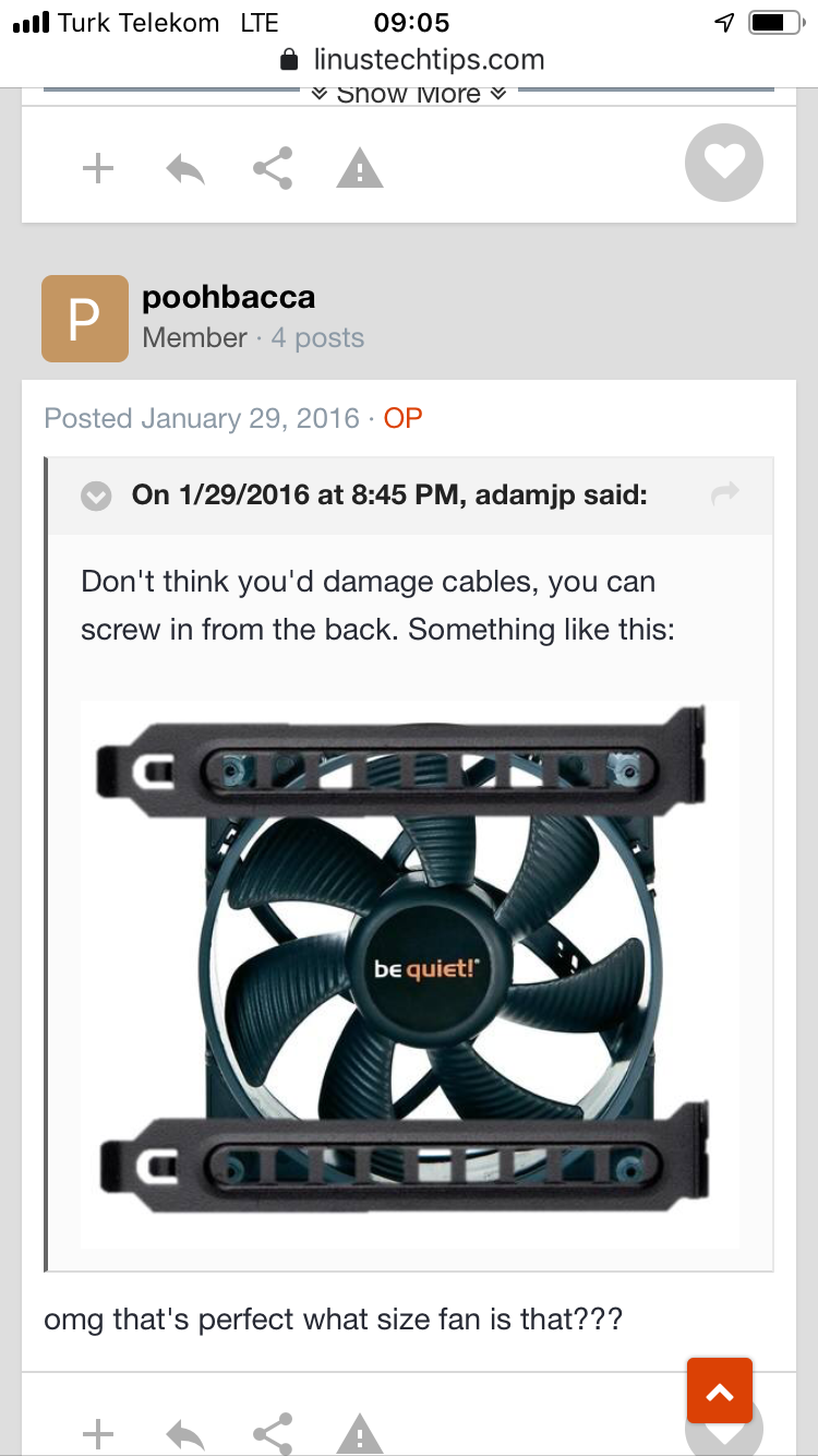

Cooling, I see the issue with the gpu overheating and it is not worth reversing airflow in such a case. I am wondering if I Mod my remaining pci slot covers to hold the attached fan(92mm I think) as an intake would both gpu and cpu temps be lower than the standard front to top airflow path. I might face a problem where if I run that 92 as an intake it might work in the counter direction of the gpu fans leading to higher temperatures. Any ideas?

A 92mm fan there would indeed provide substantially more airflow to the bottom fans which would decrease GPU temps. You should also be able to use a magnetic dust filter (even if it's only 120mm) to make this a dust free intake as well.
I personally recommend these filters (I have never actually used them before) but their thin weaving coupled with their density provide great dust filtration which not totally impeding airflow.
