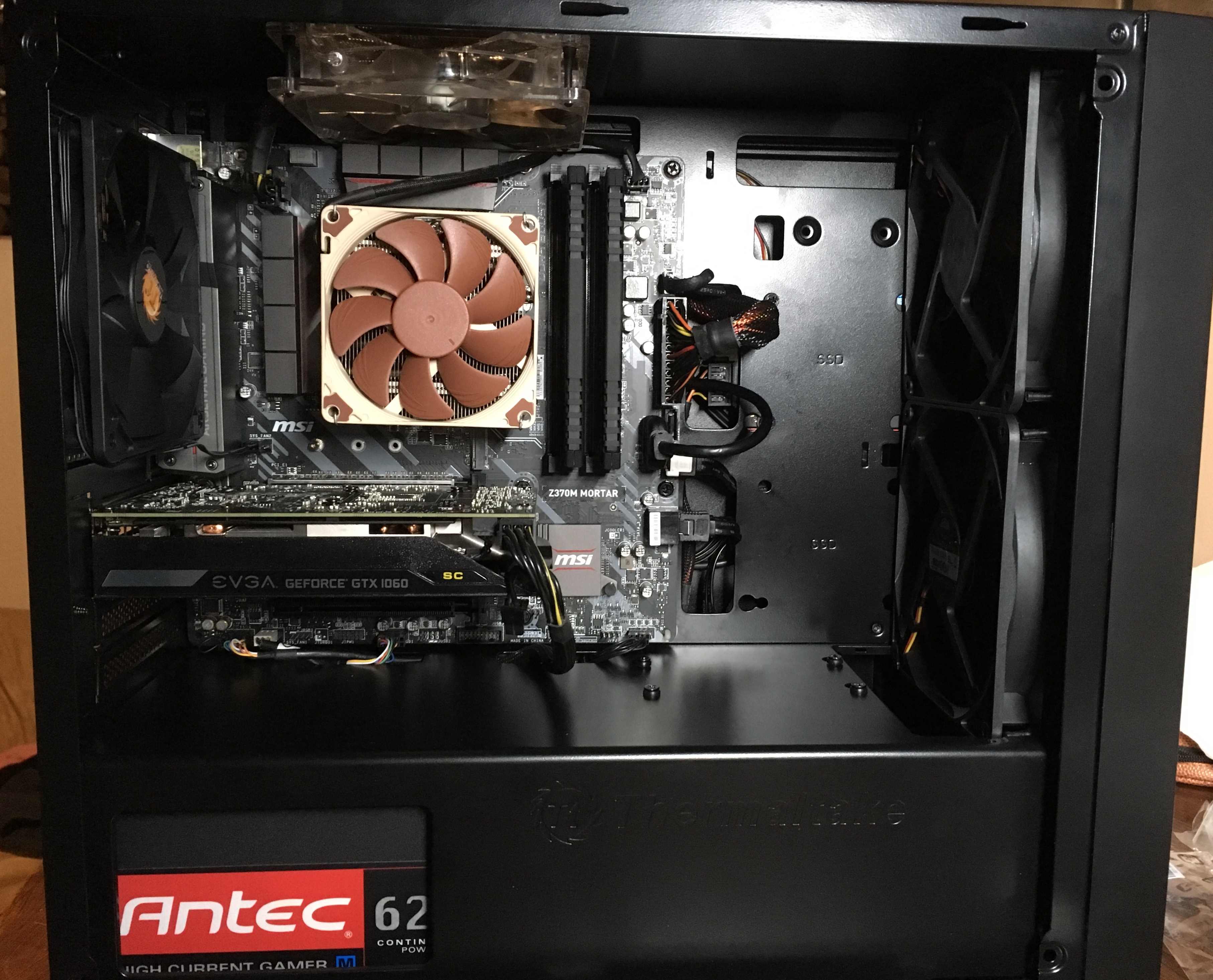

 I recently build my new PC after my seven-year-old pc, and i decided for msi z370 mortar, i5 8400, 16gb corsair rgb 3000mhz, gtx 1060 sc, samsung 970 evo 250 gb, my old coraair ssd sata, 3 tb hdd drive and antec 620w.
im using the pc with windows 10 home with or without overclock its been a pain in the ass. Gamea crashes, and bluescreen with different errors everytime. Idk what i did wrong so i need help, is the first time im having this kind of problem and my only hope it is a config thing with the nvm ssd drive.
bios is in uefi mode, my drive is in raid/optane, optane genie activated. Tell me if i need to give more info

Ok, first...drivers i already install all of them yeah.
cable management i think is ok and secure. I tried overclock the ram only cause i dont have a “K” processor.
temps:
GPU average on gaming 66C
Hdd average 26C
CPU 30C
i cool my cpu with Noctua NH-L9x65
i tought optane deliver better performance for an m.2 drive.

I finally found the problem. Probably a tipping error. I start to read every option on my bios and i found on pci latency timer was in 192! Instead of 96. I changed it and it working fine finally!
cant believe i missed that lol
thank u so much for ur cooperation xD
