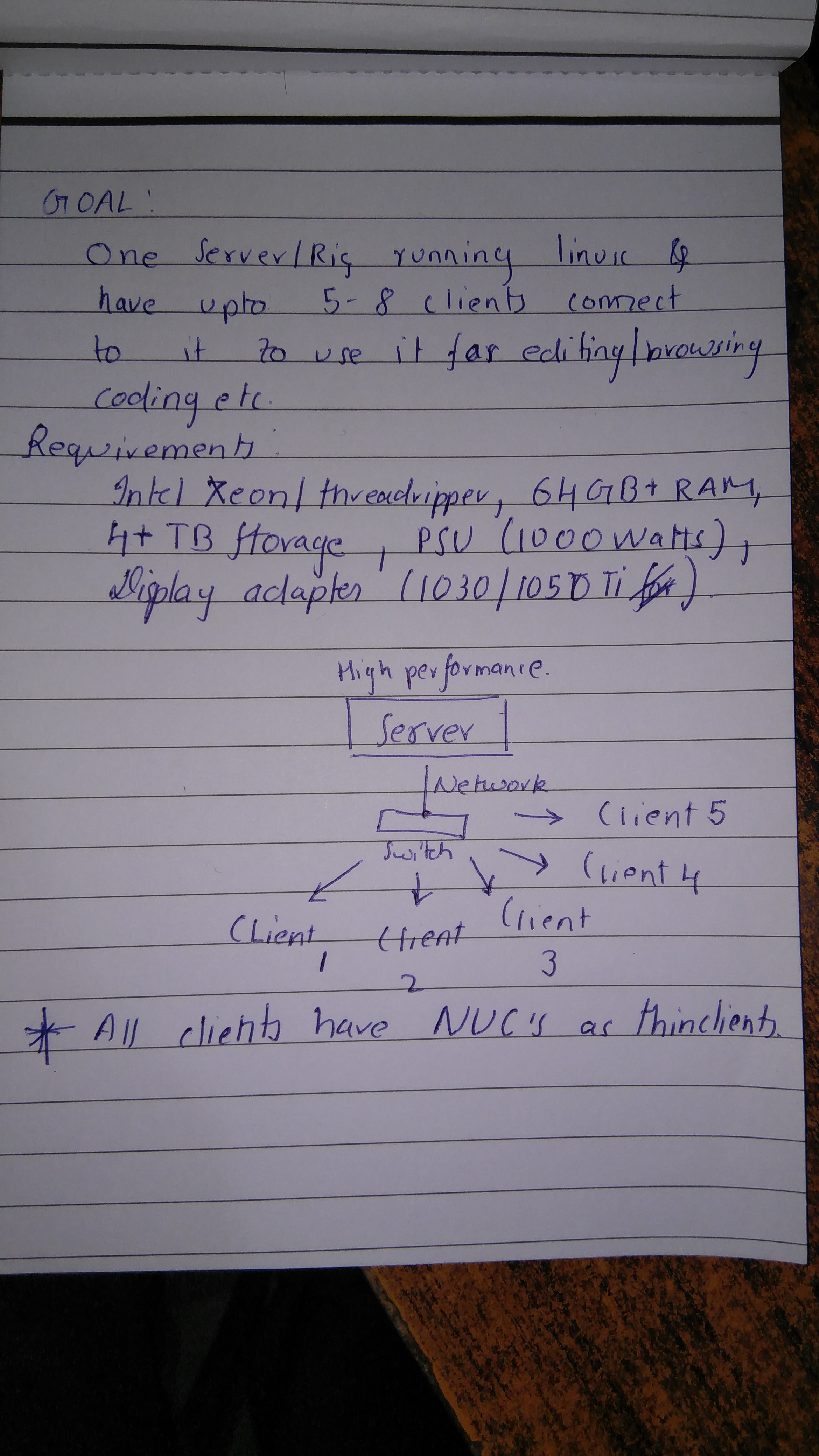

Hey, Guys!
Out of curiosity, Can 1 Server/PC be setup in such a way that it can be used as the main workhorse and connected with multiple thin clients to be used for Work? I am attaching a photo below to make it easier for me to communicate my idea :P.

Oh ok, How can I use this setup for the below-mentioned purpose.
32 minutes ago, manikyath said:
we shall continue then, do the users need to do anything graphical?
(past like, editing a word document)
Yeah, I need a GUI as we would use it for Browsing, Word Docs, Coding(Development), Designing(Photoshop..)
AND I FORGOT TO MENTION I thought of having different os( Linux for me, Windows/Linux option for others) on VM according to the needs of my team.)

https://linustechtips.com/topic/829597-5-users-one-serverrig/#findComment-10380424
19 hours ago, Navneet Suresh said:
I plan to have Linux preferably Ubuntu Server as main server OS and have other os on VM/Virtualized.
Server:
  • Install Ubuntu Server
  • Setup KVM
  • Setup all VM's
  • Install qxl-drivers on all VM's
  • set VM's to use SPICE
Thin clients:
  • Install a lightweight distro without DE (suggestion: debian or arch)
  • Install XORG + XINIT
  • Install a SPICE-client
  • set SPICE-client to execute in .xinitrc
  • connect SPICE-client to desired VM
I never tried it (but will in the near future), but it should work
