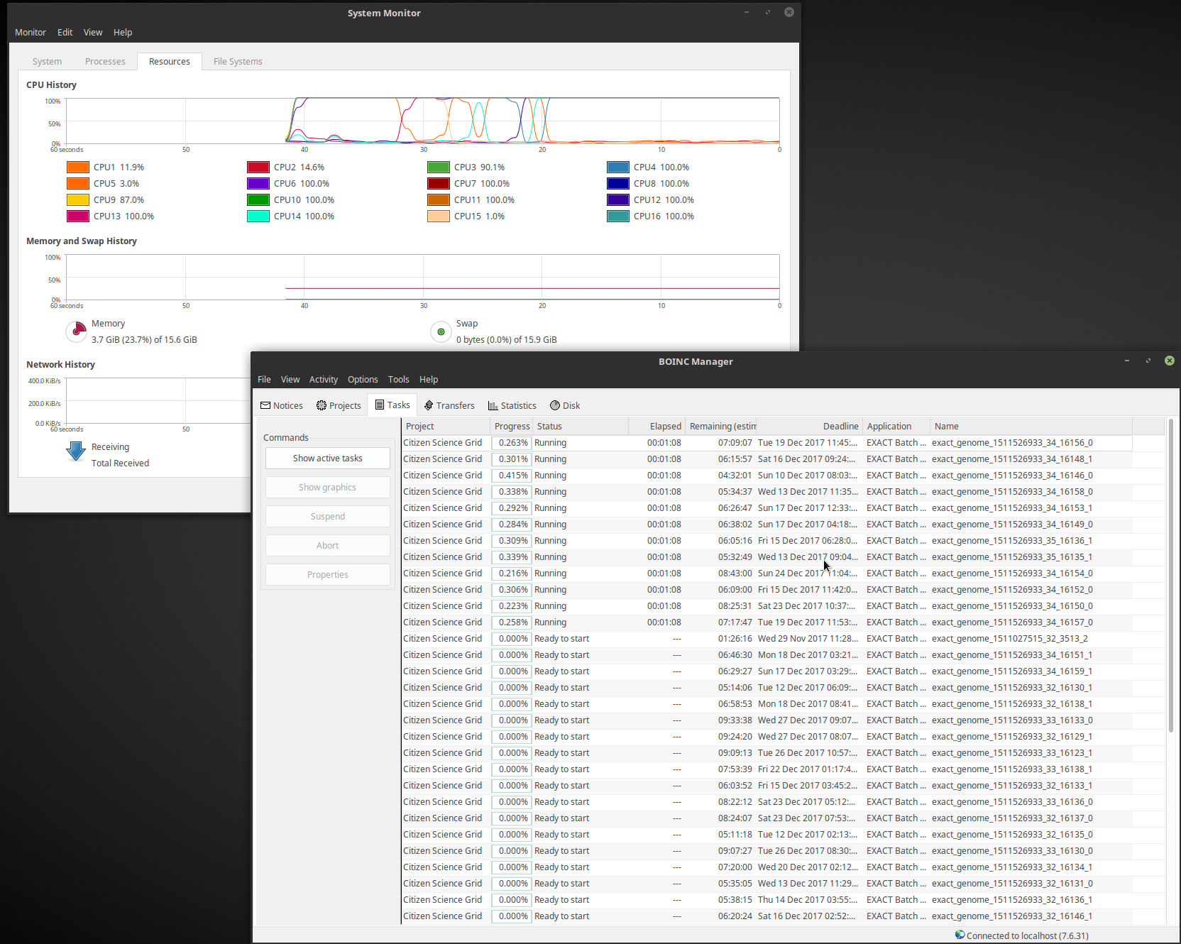

Now, open up BOINC because I don't think you want your CPU pegged at 100% usage if you plan to use it.
5a18441498a2a_Screenshotat2017-11-2410-48-01.png.6c7618b2712f03c208b1c0d292b69654.png
This is basic view.  It is usable, but kind of lacking once you get the hang of Advance View.  To change Views, click View then Advance View.
Alright, time to change Compute Preferences.  Click on Options then Compute Preferences.  You will get a screen like this one.
BOINC by default puts CPU at 100% on Usage Limits.  The first percent space controls how many threads will be loaded on the CPU.  The second percent is CPU time/load.  I usually like 80% on the first with 99% on the second, so I can use the computer.  Otherwise, I will set the first to 95% during big BOINC events.  Best thing to do is play around with the usage limits to see what load you prefer on your CPU.
5a184423c02ea_Screenshotat2017-11-2410-50-27.png.2a3086def237be730315d891038bfbfa.png
Most of the rest are easy to understand.
You can control how BOINC will handle the GPU if any projects are using it and set how much days of work you want stored up.   For just casual BOINCers you probably fine on the defaults, us nutty big time BOINCers who compete in the Pent mess with these settings a lot for bunker techniques.
Click OK once you are done setting your preferences.  Now, your computer is off to the races.
5a1844297cd52_Screenshotat2017-11-2410-52-47.thumb.png.235f7f0e7e61245928081f776daa391a.png
