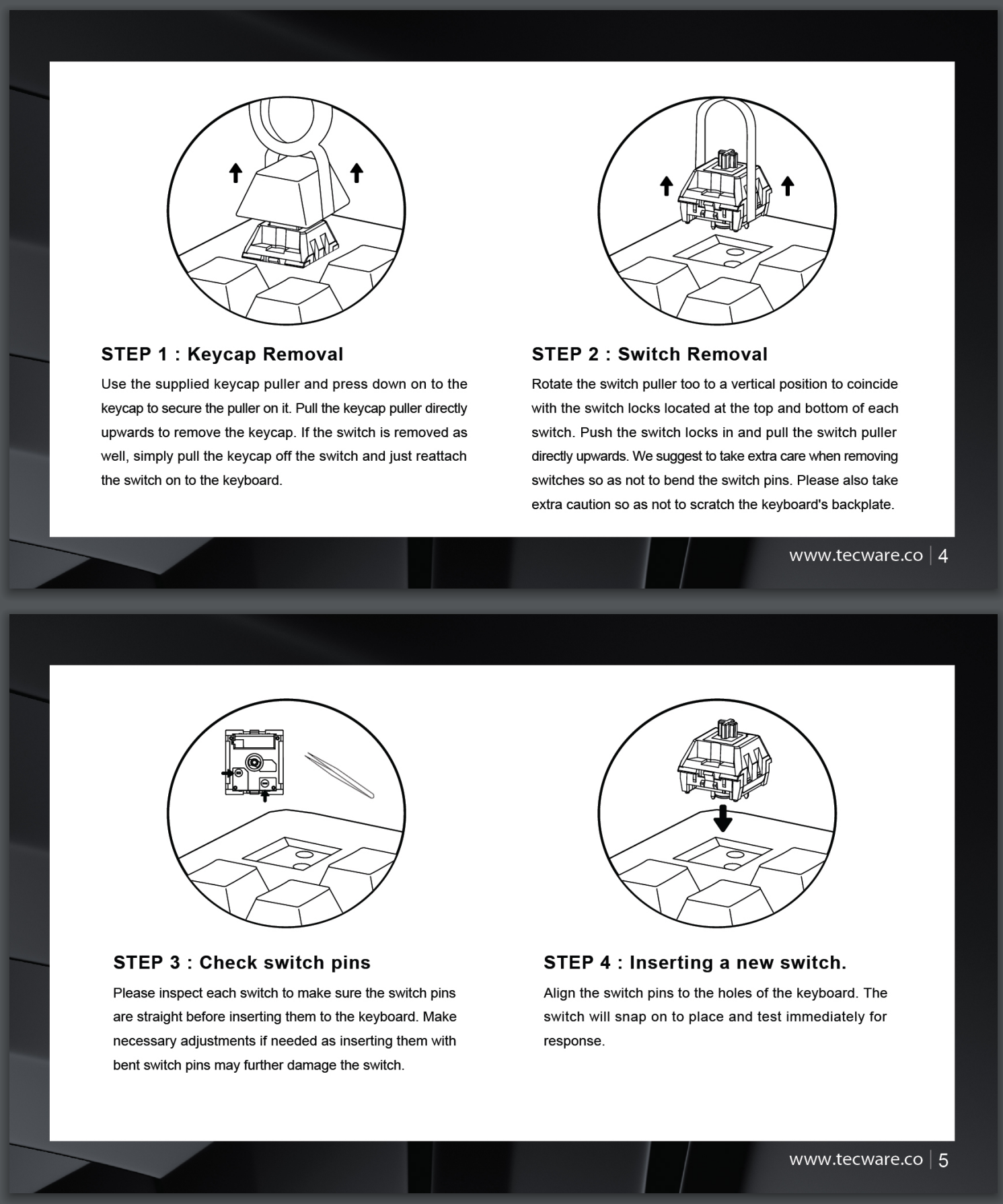

From the manual:
You can probably insert all 'Cherry MX'-like switches. Including Cherry MX, Outemo, Gateron, Kailh, etc.
4 minutes ago, minibois said:
From the manual:
  Hide contents
I appreciate your help, although a lot of people said that this keyboard is hot-swappable, but only for Outemu switches as the pins or legs model of Outemu switches is different than other "Cherry-like" switches, so you need to do some modification on your switches if you want to install it. If not, you may bent the pins of your switches (lets say Gateron switches)
Well.. I see now why Outemu is a brand/line of switches I would never recommend...
Looks like they cloned Cherry MX in every way, except for the size of the pins.
Their legs are narrower, so you would have to cut the legs of any other switch, but the legs are so small already I couldn't recommend that..
Looks like Outemu is the only choice you could make in this case..
