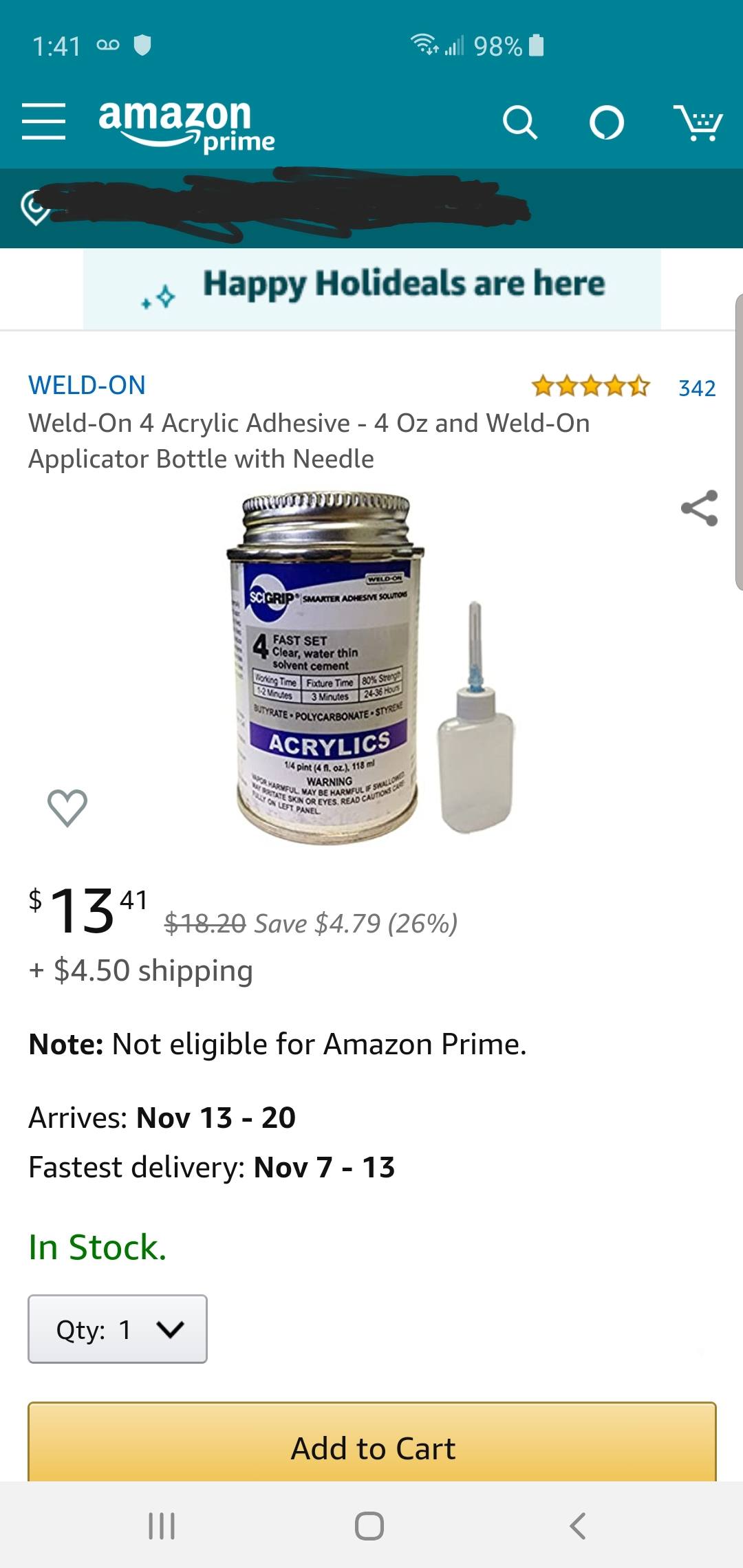

3 ways to make angled joints with plastic:
Bend: Acrylic becomes compliant at around 110C. Place the sheet on a flat base surface with a straight edge. Prefeably not a sharp edge. Use 2 strips of wood on top. First strip should be placed flush with the base surface edge. Second strip is placed next to the first one, spaced apart by plastic sheet thickness + a bit for bend radius. Heat the plastic sheet from below until it starts to sag and then heat from above, making sure to aim the airflow in between wood strips. Push on the overhang to form the bend. Heat for a few seconds to relieve stress. Let cool.
Screw connections (support or not). Cut, drill, screw, repeat.
Glue(weld). Gluing and welding acrylic takes a few tricks. Cut pieces and "dry" fit them with tape. Then, pivot open the joint, apply glue/weld solvent and press together. Viola: less overflow from the joint and it allows better solvent evaporation. Take note that welding joints need a specific solvent flash time and more pressure.
the bending is hard, personally i would buy an acrylic maybe 3x3 cm rod, then use that in the joint so you have larger attacment surfaces, when gluing... it will however not look as great as a bend, but is easy to do... since it is just cutting.
