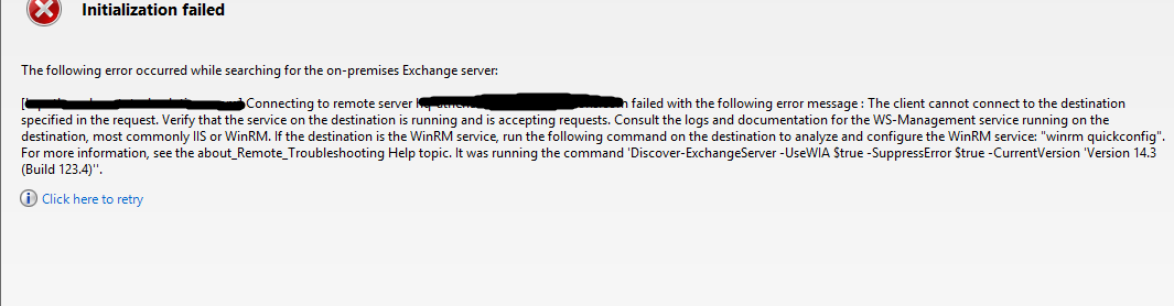

I need help ASAP. My Exchange Server decided to crap itself. I'm Getting this error:
I came home from a trip and I saw this.

Done any windows updates recently?  Error is related to SSL certificate and the protocol in use.
I'd log in to the exchange server locally and review your SSL certificate configuration and see if you have recently installed KB931125
Nope. I haven't even touched the server while I was away. The certificate works. I tried it on another server.
This is what I'm getting when I open the EMC
10 minutes ago, userzero said:
Check time and date. Check SSL cert. Maybe clear SSL state.
The SSL is fine. Works on the other servers
https://linustechtips.com/topic/943872-exchange-server-help/#findComment-11499254
Check certificate configuration is correct on the *:443 binding then restart IIS.
I would suggest you also make sure all exchange services are running and review the event logs.
Everything is correct. :/:( Services are working as it is. :(
https://linustechtips.com/topic/943872-exchange-server-help/#findComment-11499288
6 minutes ago, Falconevo said:
Start reviewing your event logs, it should be the first place you start as a server admin.
Found the problem. Old IP was binding to port 443. I had remove it adding the new one :D
I used the "netsh https add iplisten ipaddress=x.x.x.x" command.
https://linustechtips.com/topic/943872-exchange-server-help/#findComment-11499304
Good to hear, I'd probably suggest the binding be updated in IIS for the correct IP and cert mapping.  Will save you having to do that again.
