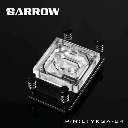

The pic I attached shows my plans for the res->pump positioning. They will be approximately horizontally aligned with one another. My plan is to go Res to Pump to Rad (240mm on bottom) to GPU to Rad (mounted on rear 92mm) to (potential second 240 rad on roof if I can get it to fit, it will be passively cooled) to CPU and then finally back to the Res. Does all of this sound OK? Also, do modern waterblocks (mine is Barrows) have a specific in/out for the CPU block? I can't tell if there since there doesn't seem to be any manuals or markings on the CPU block (img of block)

That is alright but just ensure your res is always more than 2/3rd full to ensure the pump doesn't ever run dry. As for the CPU block most these days will have flow direction check the documentation but if I'm correct the port near the barrow badge is the inlet.
