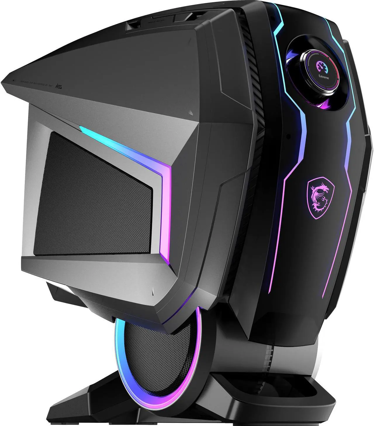

Here is my current setup :
Monitor : MSI Optix MAG342CQR (3440x1440)
Computer MSI Meg TI5 11TD220CA (fancy alien looking case)
CPU I7 11700K
32 GB DDR4
NVIDIA GeForce RTX 3070 (8GB)
Power 850W
Was planning to upgrade to a GeForce RTX 5070 TI (16 GB) or a 5080 (16 GB) as some of the newer games struggle at 3440x1440.
Here is my question.
1- Is my CPU fast enough for that GPU or I would be bottle neck? How can we know what is a bottle neck on a computer without just trying it out????
2- Is 850W enough power or I would need to upgrade for a 1000W (that case need a SFX Power Supply).
Thanks

3- Good question. It is very hard to get to the Power Supply. All I know is this :     850W 80 Plus Gold certified (SFX)
4- Also a great question. I have lots of room as the video card is on the top in it own chamber. So the lengh should not be a problem. That case in a different trim can fit a 3090.
MEG Aegis Ti5- Path to the future | Gaming Desktop Computer ...
yeah, but cards still have rated mm length, if that chamber is small they'll just use small GPUs to fit it, but small GPUs aren't always cheapest, although usually they are since they're the 2fan versions
