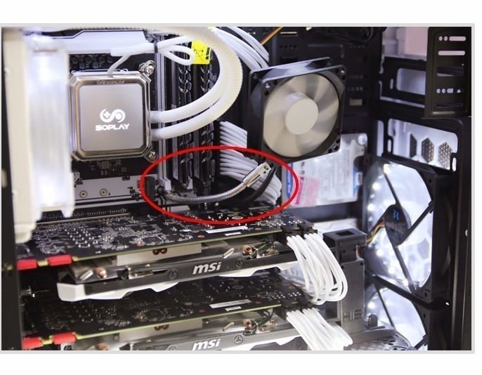

You see, the thing is with 5.25" devices is that they are designed with front access in mind (optical drives, hot swap drive bays, etc) and so any 5.25" bay will never have a fan in front of it.
Furthermore I do not think there is a real consensus on how deep a 5.25" device is, and so there is rarely any defined mounting for fans on the rear side of the device.
Lastly, the only thing defined about the 5.25" device is the width, which is how the device is usually clamped in place by the chassis, and so you will never get adequate side ventilation either since this is reserved for structural rigidity.
Therefore if you want airflow to your devices you're probably better off getting a spot fan and mount a standard case fan either pushing air onto or pulling air away from the devices.
https://www.moddiy.com/products/ICEAGE-J1-High-Efficient-Performance-Flexible-Metal-Fan-Mounting-Kit.html
ICEAGE_J1_High_Efficient_Performance_Flexible_Metal_Fan_Mounting_Kit_%281%29__49020_zoom.jpg
