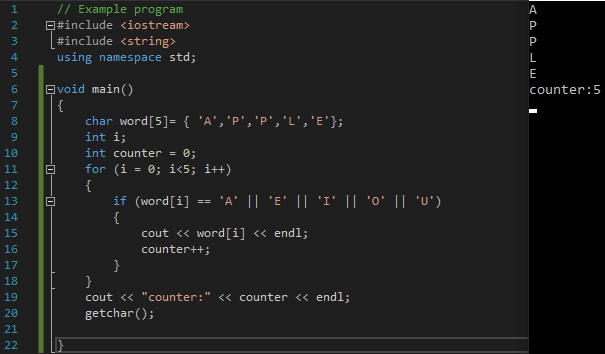

Operators in if statement with char array
In this task the counter should give me the number of vowels in the word apple.
#include <iostream>
#include <string>
using namespace std;
void main()
    char word[5]= { 'A','P','P','L','E'};
    int i;
    int counter = 0;
    for (i = 0; i<5; i++)
        if (word == 'A' || 'E' || 'I' ||  'O' ||  'U')
            cout << word << endl;
            counter++;
    cout << "counter:" << counter << endl;
    getchar();
When I run it this way it outputs like this:
A
P
P
L
E
counter:5

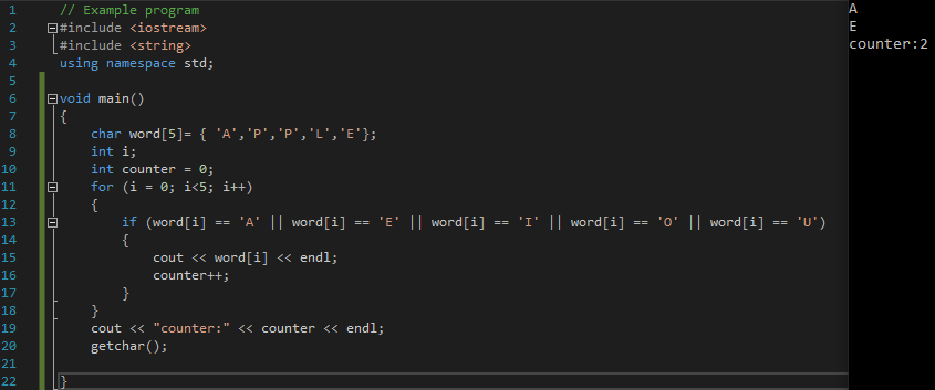

But when I run it like this:
#include <iostream>
#include <string>
void main()
    int i;
    int counter = 0;
        if (word == 'A' || word == 'E' || word == 'I' || word == 'O' || word == 'U')
            counter++;
    getchar();
This is what it outputs:
A
E
counter:2
Why is the first method wrong?

Because you have to specifically specify what your OR comparison is checking (as you are in Example 2). This
Is not short hand for
If you compare a value directly in an if-statement and the compiler can map a value directly to a boolean, then typically if the value is < 1, it's treated as false, otherwise it's true.
Given the first example's if-statement:
After word == 'A', the rest of the checks resolve to true because they're 1 or greater, so the entire if-statement always passes.
Yea I guess I'm wondering why those 2 lines don't do the same thing
Because the compiler resolves the first example's if-statement to
if (word == 65 || 69 || 73 || 79 || 85)
Which I said before, a conditional check on a straight-up value is basically the same as:
if (value > 0) {
	return true;
else {
	return false;
Edited by Mira Yurizaki
Flipped the if-statement on the value (beacuse blah)

This seems like a fundamental misunderstanding of how the "if" statement or, more generally, comparisons work in c-like languages.
When you use a logical operator like "&&" or "||" the compiler will evaluate the statements on its left and on its right to a boolean (0 or 1) and then apply the operator. Characters are just 8-bit numbers in c and c++ and any number that is larger than 0 is usually evaluated as "true" for logical operators if it's the only part of the statement.
The "==" operator returns "true" (1) when the statements on both sides have the same value - so in your case, 'P' == 'A' would evaluate to "false" (0) but 'E' on its own would evaluate to true, so in effect you'd have:
if(word[i] == 'A' || 'E')
which evaluates to
if(0 || 69)
which evaluates to
if(0 || 1)
which evaluates to
if (1)
which is true.
