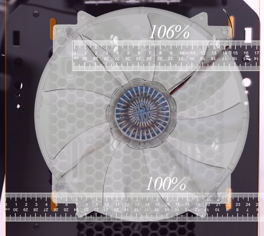

Screen shot taken from: https://youtu.be/OFxNcJ2noiM?t=325
Bottom ruler is scaled to the 250mm wide case.
Top ruler is scaled to 105mm distance at 120mm fan mounting holes. Comparing the two, there's ~6% distortion from the photo between the wideness of the case and spacing of the holes.
Even using the larger ruler to size the 200mm wide Megaflow, it seems a bit smaller than the orange highlighted mounting holes. This is likely to be from distortion from the camera and my correction for perspective but it looks to be ~6% anyway. the Megaflow photo is probably a bit distorted from camera as well but there aren't any great photos I could find. All I did was rotate it a bit.
