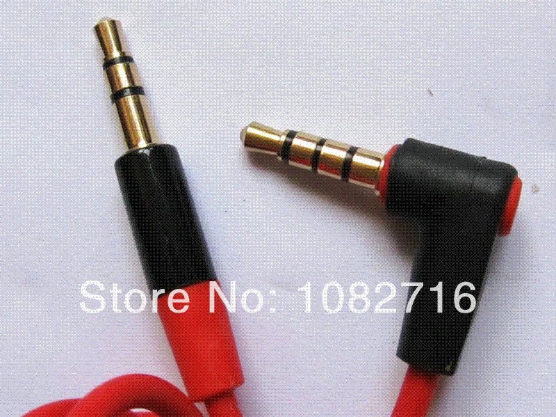

So you only have one 3.5mm port and your headset has a 4 pole connector on it?
2pcs-red-straight-1-8-in-3-5mm-3-pole-ma
Left is 3 pole, right is 4 pole.
Typically laptops have a combo jack and you can use a 4 pole cable. Usually desktops have two separate plugs (often labeled green and pink for headphones and microphones respectively) and you need to get two separate 3 pole connectors.
