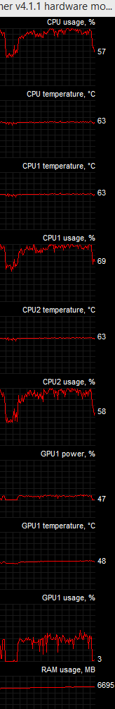

@Minibois yes it does , gonna run GTA right now with msi afterburner

the results, forgot to take a picture at the same time for my thread 3,4 I got one but was a little after I closed GTA V so just look at the start of the graph
but i also see that my GPU usage never exceeds 50 does this mean that if I get an i5 I would even get better performance ?
