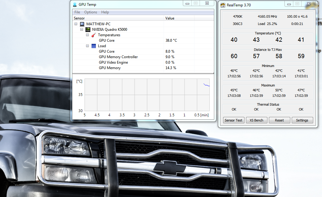

Doesn't my CPU die if i'm rendering video's which take more than 30min to render while my CPU is around 90-95celcius during the whole process?
How can I actually know or test whether I need the EVO 212 or if I can keep my stock cooler?
https://linustechtips.com/topic/341592-i7-4790k-cooling/#findComment-4672101
90-95c are quite high temps. If those are your load temps, I would suggest getting an aftermarket cooler.
Check your rendering temps and report back?
https://linustechtips.com/topic/341592-i7-4790k-cooling/#findComment-4673322
Same temps I'm getting while rendering  with stock coolers. Got around 60C after installing 212 EVO. Keeping your CPU cool can prolong its life.
