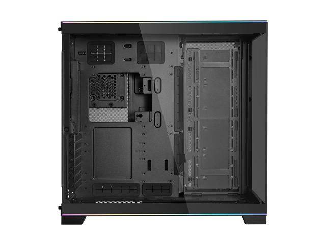

Lain Li O11D series still have rubber grommets for external tubing. The Normal D's only have them on the Rear chamber side (where the PSU and HDD's go), but the XL's have them in the main chamber. In the normal variants, you could route tubing through the extremely sizable grommets in the main chamber to the rear to get access to the external ones. But I do understand it's more of a hassle.
O11D EVO RGB
O11d XL
I'm not sure how you feel about the "fish tank style" of cases, and it's a lot more glass than you might be comfortable with high speed dog tails
O11D EVO RGB
O11d XL
Those look like a potential option. Looking at more cases though I think having one with top mounted case IO would be better since it will sit on the floor.
