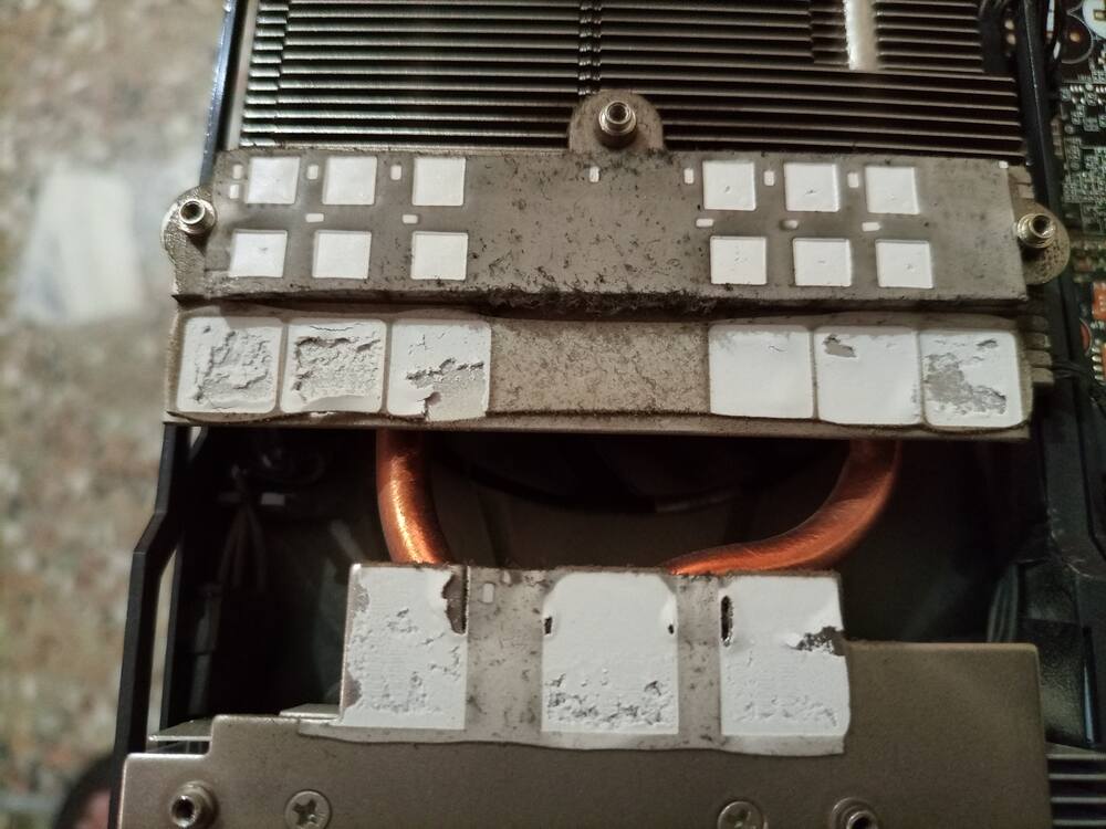

I found a post in another forum where someone asked about the thicknesses and no one answered him, he posted this photo, so now I added the thicknesses on top of it: (Not my photo, but the same card)
