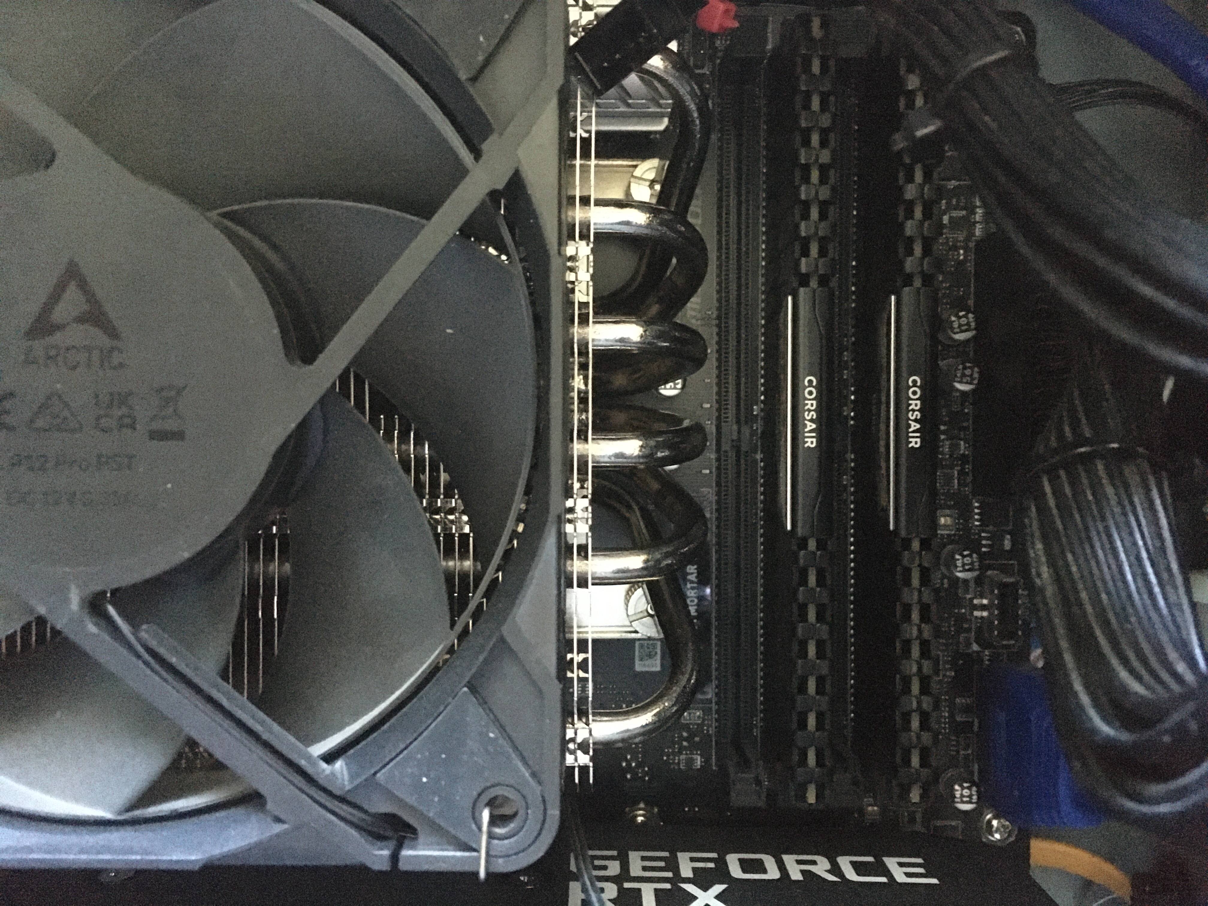

I've got the cooler the other way around.
I recommend using a 25mm fan like the Arctic P12 Pro if you can
I think it's 67mm high with the 15mm fan (as the name implies)
