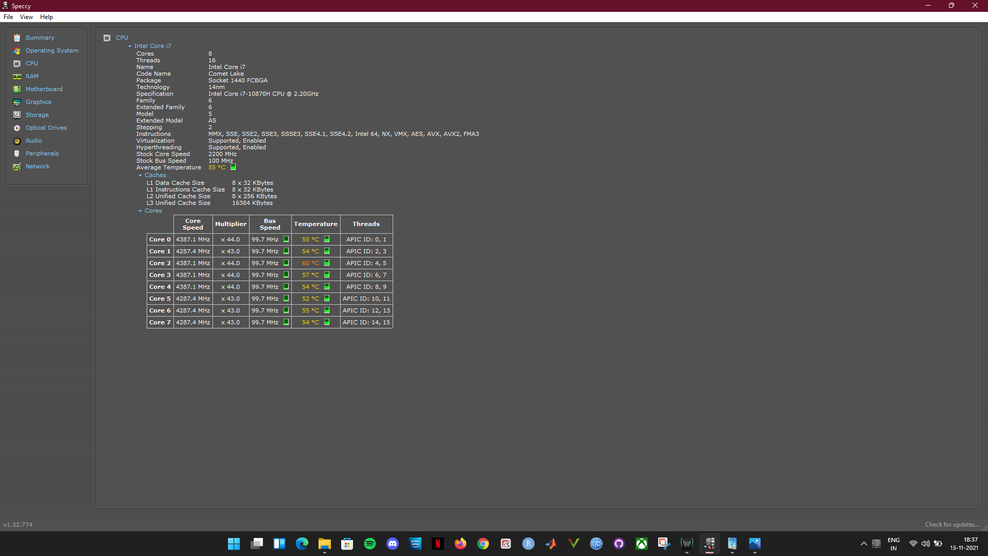

No luck Phani 😞 What do you mean by singel threaded stress tests? Can you refer some software for that pls?

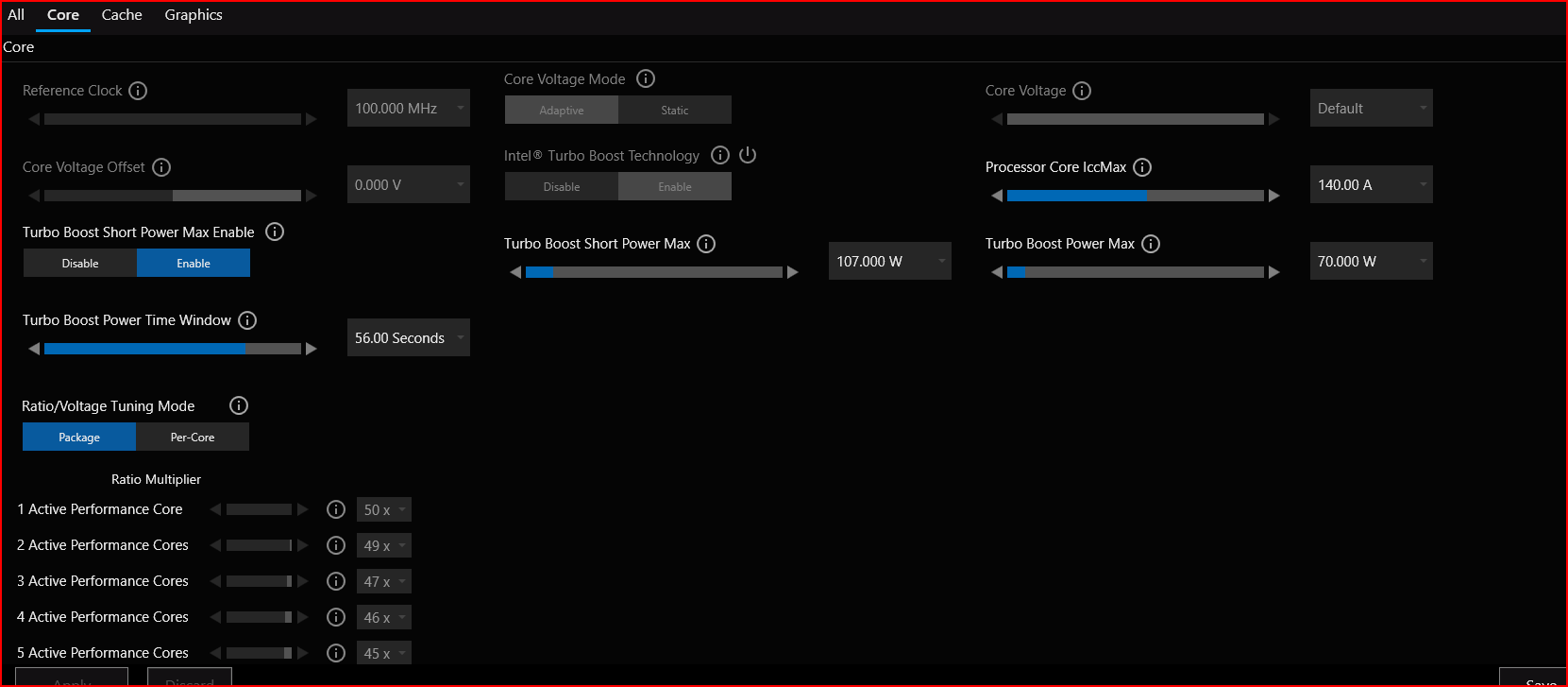

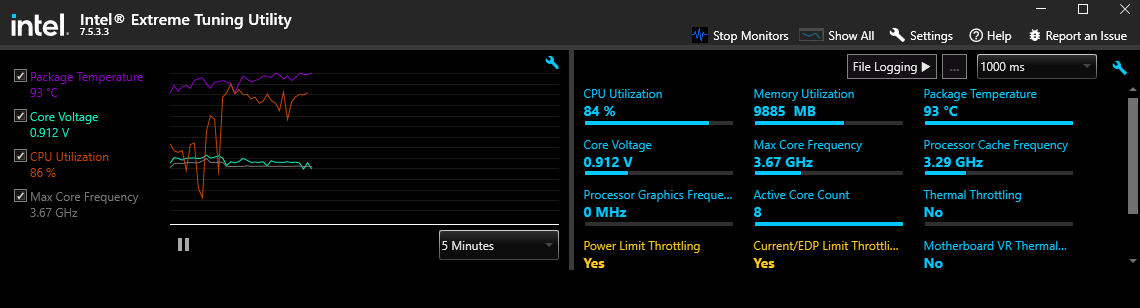

While playing cyberpunk intel XTU says this
And attaching Speecy's screenshot when laptop is on normal load, the maximum I see it goes to x44 multiplier.
Those C state numbers look fine to me...
What frequency is your CPU capping out at? I can see one of your core is at 4.7GHz...
ThrottleStop 9.4
https://www.techpowerup.com/download/techpowerup-throttlestop/
ThrottleStop shows your C states are working correctly and it also shows your CPU using the higher multipliers when lightly loaded. This is normal.

The 10870H has a 45W TDP rating.
https://ark.intel.com/content/www/us/en/ark/products/208018/intel-core-i710870h-processor-16m-cache-up-to-5-00-ghz.html
Acer laptops typically enforce the TDP limit. That means when playing a game, your laptop CPU will slow down so it does not exceed 45W. Your XTU screenshot also shows current EDP throttling. Sometimes you can fix EDP throttling by raising IccMax or Power Limit 4 if they are not locked.

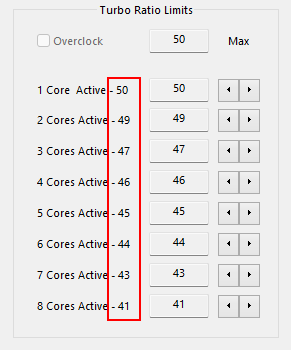

The ThrottleStop FIVR window shows in the Turbo Ratio Limits section what the default multipliers are for your CPU. You do not have a fully unlocked K series CPU. The H series CPUs are designed so that the maximum multiplier decreases when more cores become active. Post screenshots of the ThrottleStop FIVR and TPL windows if you want to know what your options are.
Acer likes to set the thermal throttling temperature to 92°C instead of the full 100°C that Intel recommends. There is a way to adjust this higher but I think Acer locks out this feature. Look for a lock icon near the PROCHOT Offset setting in the Options window. If you see a lock icon, the thermal throttling temperature cannot be adjusted.

This shows the default Turbo Ratio Limit values for your CPU. When all 8 cores are active during a stress test, the multiplier will max out at 41. You do not have an unlocked K series CPU so there is no way to go beyond this built in limit.
