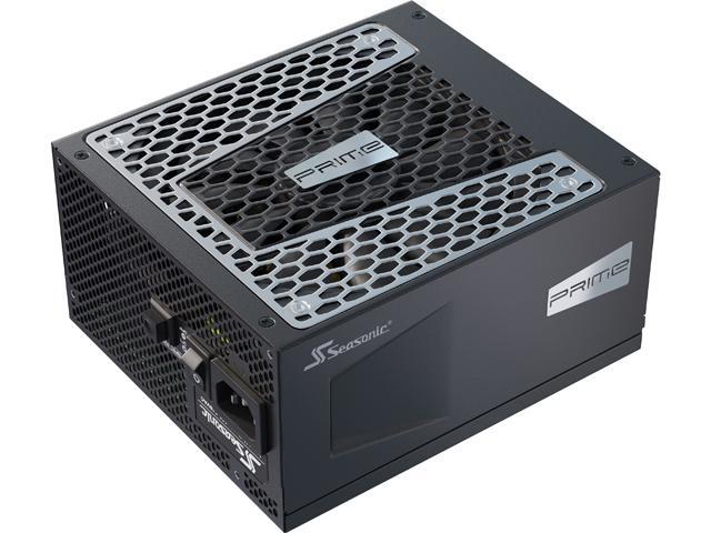

1 minute ago, jonnyGURU said:
Does this look compatible too?
Image result for seasonic
Hm, nope? Look at the holes, some are square, some have little triangle edges. The CPU ones from above look like
STTS
TSST
to me, while yours look like
STTT
TTSS
