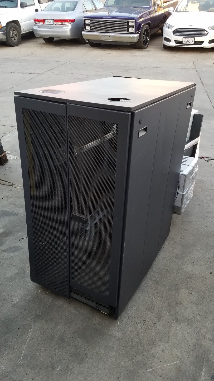

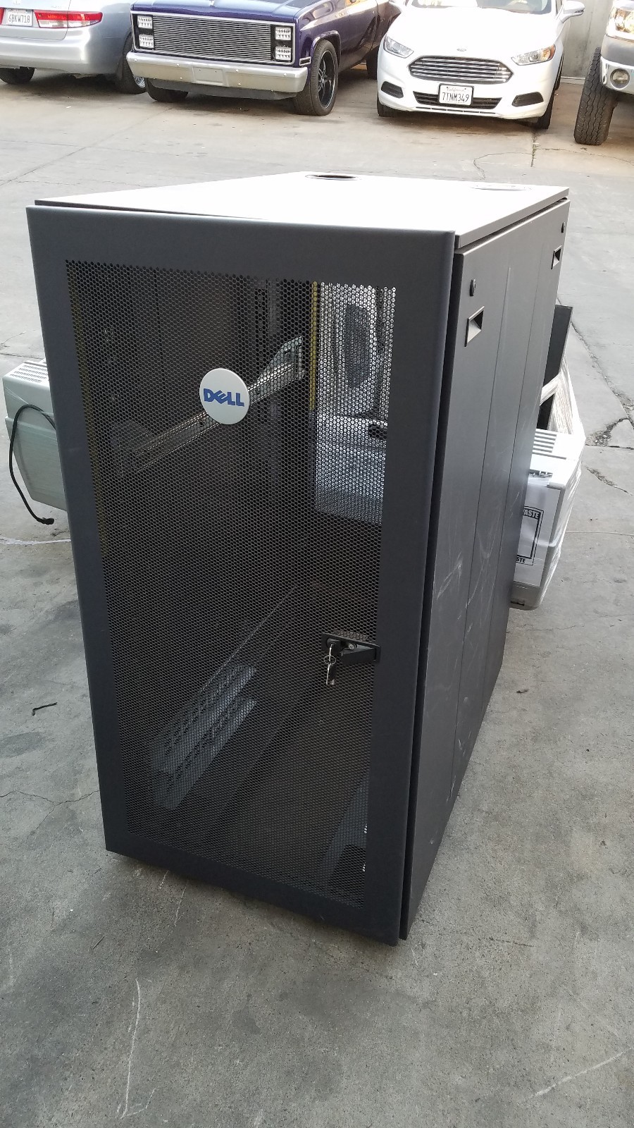

I found an older Dell 2410 on eBay within driving distance for fairly cheap. Haven't contacted the seller yet buy I'm worried about 1 thing:
It looks as if the panels are misaligned judging from the pictures. That tells me that the case is probably damaged somehow or is not completely perpendicular?
Note how the doors and panels don't line up correctly:
Would that be caused due to it being on an uneven surface or angled surface? Or is the case just not square/perpendicular due to some other damage? Will filling it with equipment help as it increases the rigidity?
Its never 100% possible to tell from pictures. from personal experience the rack is probably just fine, especially since the doors and panels have zero impact on the vertical racking rails or the ability to mount hardware. Lots of used racks have dings and dented panels and I'm sure much of the damage is easily fixable, and potentially the doors could be straightened too. I would be happy to buy that rack for a decent price. Minor misalignments and stuff on cosmetic panels that you only require for sound dampening shouldn't deter you unless there is something structurally wrong with the cabinet (very unlikely).
