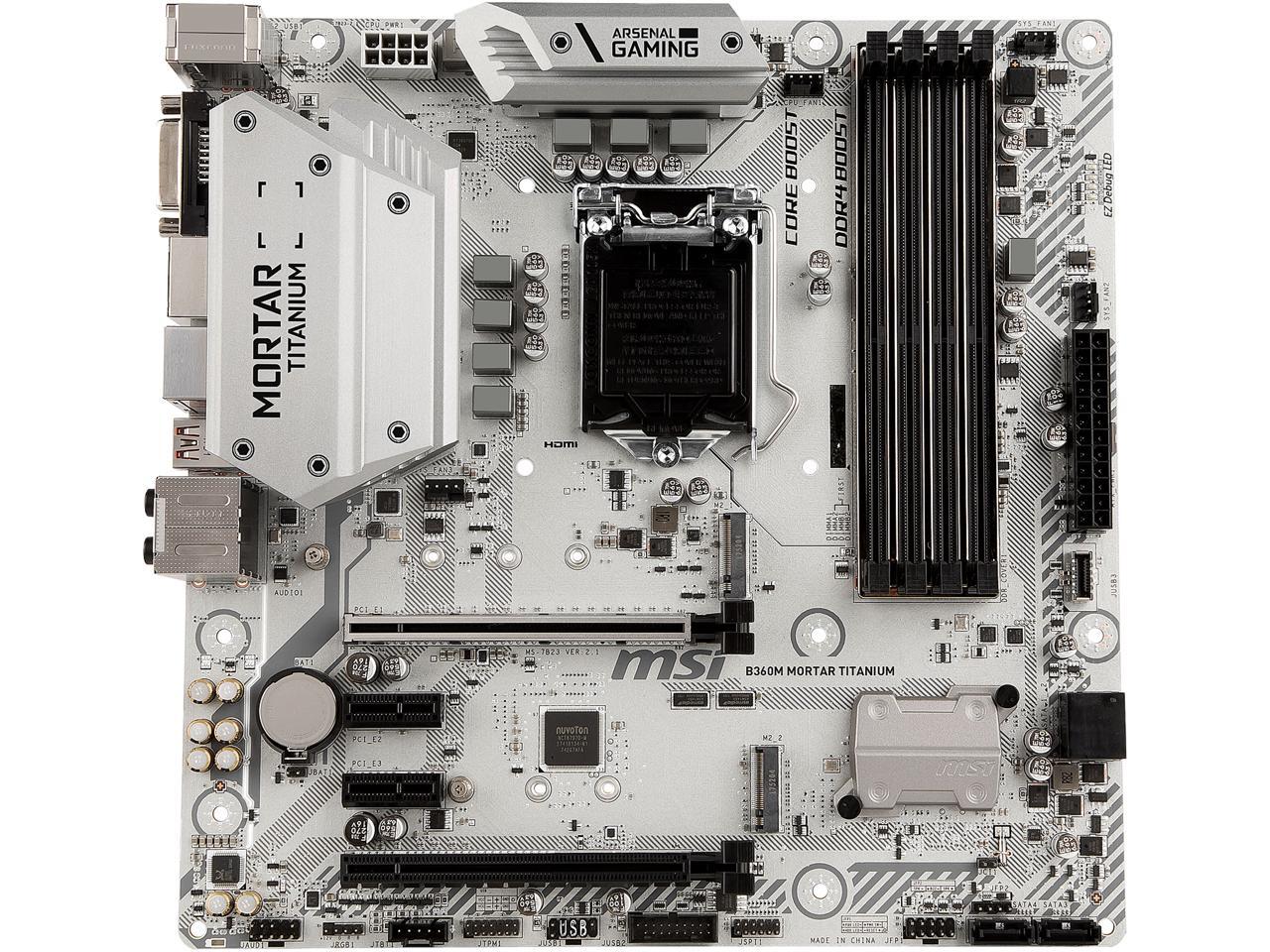

Hey guys! So I'm trying to install my motherboard into my case, but I have an issue that might not be one at all. I just need help.
My Fractal Design Meshify C case came with 8 standoffs and my EVGA z370 motherboard has 10 standoff slots. Do I have to use all 10 or will the 8 be fine?
Can someone circle which ones I can leave out if it's possible?
Thanks!! I dont want to have to get a different case unless I have to...

To clarify, you have 8 standoffs, but the one on the center should be already filled in. Kinda like a free space in bingo.
The Fractal Design cases use a middle alignment standoff nipple to help align the motherboard to perfectly match the other (however many) holes you're using for your motherboard (whether thats mITX, mATX or ATX)
Therefore I recommend the following hole layout
Blue Is your freebee standoff
Green is the recomended stand off locations
Red is the one you can omit
https://linustechtips.com/topic/976889-too-many-mobo-standoffs/#findComment-11799403

I am in tears of how many suggestions I am getting. Tears of both sadness and happiness because I don't know which advice to follow...
It makes sense to omit the red one circled because there is one directly above and below it. Is that why you suggest that one? @TVwazhere
But what @Stefan Payne said also makes sense, if it's not on most other motherboards than it shouldn't be an issue.
Correct.
Most ATX motherboards do not have that screw hole spot. For example I just went to newegg, typed in ATX motherboard and this is the first one that came up; an MSI B360. Note that it does not include that hole location I marked in red in the above example at all!
https://www.newegg.com/Product/ProductList.aspx?Submit=ENE&DEPA=0&Order=BESTMATCH&Description=atx+motherboard&ignorear=0&N=-1&isNodeId=1
That hole is most commonly used for mATX boards, demonstrated vividly well here on this MSI B360 Mortar Board
It's like they knew to circle the hole cutouts!

You know what, I'll use your answer. It makes a lot of sense to me comparing it to other motherboards and also just physically.
Thank you!!
