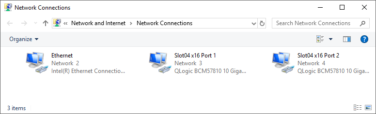

Did you go into Network Connections and see what Network Adapter is actually reporting No Internet? The icon in the task bar might just be reporting No Internet from the Wi-Fi adapter.
I do not believe so. "Réseau"' means network and "Pas" means no

This is the page I'm wanting to see:

So your wired connection works just fine. The No Internet error is for the Wi-Fi adapter you haven't setup. You said the hotspot configuration requires you to show that you have internet. This right here says you do. Where does the hot spot configurater say that you don't?
The no internet shows up wether I have the wifi plugged in or not, in fact it does it since a long time. It says it here:
I'm sorry it's in french but it won't install english because "I have no internet". It basically say I can't setup a hotspot because my computer has no .Ethernet, Wifi or cellular connectiond.png.72d5d24f5c72172b6905ec280b161d7d.png
