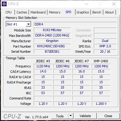

Hi i want check if My Computer RAM is Running in Dual Channel Mode.
I have a i7 6700
32 GB OF RAM DDR4 2133 Mhz
SLOT #1 , SLOT #2 AND SLOT #3 It is equal to all.
NOW ON SLOT #4 i have this:
WTF what's going on here?
Look at your part number. Your first 3 are 2400 and the last is 2133. You have different hardware based on part number listings.

Screenshot of memory tab would help.
Were the 4 sticks bought as a single kit or separately?
https://linustechtips.com/topic/670498-wierd-ram-ddr4/#findComment-8645154
2 minutes ago, THEPRO | xTreme-CM.ORG said:
can i "overclocked" to match the Slot 1 ram?
check your BIOS, the RAM is probably already all downclocked to 2133 to match the slowest one.
It may be possible but it is a lot of effort to make sure it is stable for a really insignificant gain. If you want to run at the slightly higher speed replace the 4th module with the exact same as 1st 3. I don't think it is worth it. Ideally all 4 modules should be bought in a single kit to make sure they match. The memory tab should show the current running speed.
