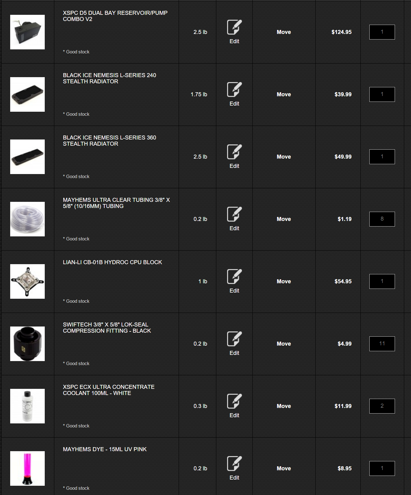

Alright, and then are the fittings correct? b060f3c9f80265d3c2aea0716a9b9e53.png
I am using 3/8 x 5/8 tubes and everything I bought uses G1/4, so it should work right?
// irenebb-pc v5 // [] Intel i5-9400F [] Radeon VII Lisa Su Edition [] 24GB Crucial Ballistix [] Acer ED323QUR (1440p/144hz) []
Yes those are a good option, and everything is standardize to G1/4" thread.

Going to buy it tomorrow morning, does it look good to order? I have a kill coil coming in from amazon to deal with growth in the loop, and PWM splitters as well. And obviously I will get a GPU with a block soon :P

That all looks about good I would go for the Mayhems coolant if you can they make some good stuff, not too sure about the pastel series from XSPC yet since they are somewhat new still.
One very important thing is to not use a silver kill coil in this loop, the premixed stuff will take care of everything, the reason being that the lian li block you have is nickel plated, nickel and silver are borderline dis-similar metals in a loop environment which can potentially cause issues with the nickel plating.
you'll prolly find that the static pressure (.44mm/h20) on those s12a fans will not really be enough to keep them at 600rpm under a 100% load to keep a comfortable temperature.. just not enough to penetrate the 54mm thick nemesis split fins. the P12 just is barely enough for a SR1 with a smaller fpi and less fin density.
Wish this was here earlier :( ordered my loop 10 min ago
try it your way to see, but i believe it will not be enough to make those rads cool properly. as stated, my p12 (1.66mm/h2o) fans just are enough for a looser fin array in 54mm thickness. those s12a fans are case fans with that as their sole purpose.
http://noctua.at/en/which_fan_is_right_for_me
It is 24mm though?
