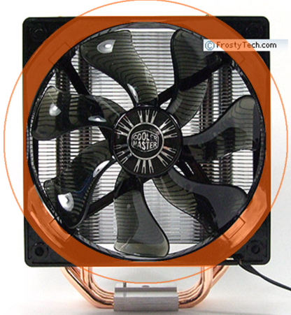

Fans tend to drive most of their air at the ends of the blades, with very little volume at the hub.  A 140 mm fan mounted directly to the heat sink would be worse than a properly fitting 120 mm fan - as the majority of the air would simpy be lost out the gaps.
The only way a 140 mm fan would work at all would be by using a step down plenum to force the air flow into the cooling fins.
Is this implying that a 140mm fan wouldn't be properly mounted?

He's saying that unless you have something to redirect the airflow for the portion of the 140mm fan that hangs past the fins on the headsink then you'll be loosing a lot of the added airflow you get with a 140mm fan over a 120mm fan.
http://www.amazon.com/Bgears-Cooling-Fan-Adapter-140mm-Black/dp/B0043GMY1U
Let's say you have a 120mm fan and a 140mm fan.
At the same RPM the 120mm fan measures 70 CFM of air flow and the 140mm fan does 80 CFM.
Most of the extra 10CFM that you get from the 140mm fan is from the outer edges of the blades, the part of the blades that will be hanging past the fins of the 120mm heatsink and with out something to redirect that airflow into the heatsink's fins then you're getting little to no benefit of the 140mm fan.
If by "properly mounted" you mean "mounted in such a fashion that the air flow generated by the fan is not allowed to escape around the cooling fins, but is instead forced to flow across them" then no it doesn't imply that.  It states it explicitly.
Edit:  This being an example of a step down plenum.

I know what a step down plenum is.
It just seemed like you were implying that that was necessary for a 140mm to perform any better on a heatsink that would normally fit a 120mm fan.
You keep using that word imply.
It wasn't an implication, it was an assertion.  And the graphic pretty much proves the point.
Do you see those big gaps where the 140 mm fan ring sticks out beyond the cooling fins?  Those are regions of minimal resistance to air flow.  The laws of simple fluid dynamics guarantee that the majority of air flow generated by the fan blades will flow out those holes.  It has to - given that that is the path of least resistance.
Whether overall performance will be worse than a properly fitting 120 mm fan is questionable, but it certainly will not be any better.
