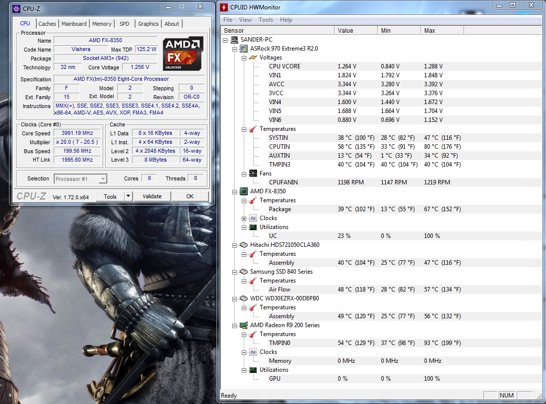

I own fx 8350 with a asrock extreme3 R2.0 and a r9 290 also the cpu has hyper 412s on it but i have some big issues because my fx 8350 is hitting in hw monitor CPUTIN tab 80 celcius this makes the games that i play basically UNPLAYABLE  !
also my r9 290 is hitting the 90 celcius mark with ease but it has a twin frozr cooler on it!
and because my cpu is hitting 80 celcius its throttling back to 1.4 ghz !
my gpu also goes back since my cpu can't keep up with my gpu (see pcitures)
so also here are some graphs from msi afterburner.

Here are some numbers of the temps:
http://i.gyazo.com/5302b5f38a6f4191a353554a0a785722.png (see the max of cputin and gpu the current temps are idle~)
So in other forum and on this forum they asked my to remove my cooler and remount it.
after that temps din't go up as fast but still throttles so thats what i already done i have no overclock except on the gpu which is 3% with a 5% energy limit increase.
and thats it some people say that it is my bad motherboard which isn't for this cpu others say that bullshit and say it can support it easily so i really don't know anymore what to do since i don't have a money tree and limited to a 140 euro budget if something needs to be swapped out so no no new cpu and motherboard tongue.gif

80C is NOT fine for an AMD FX chip. Those max out at 60C. Yes it will throttle down to 1.4 GHz at that temperature.

well MY PROCESSOR isn't fine since its THROTTLING

wel mate this is going for 4 months now and just discoverd why and how so also it is also just the cputin in hw monitor when that EXACTLY hits 80 c it throttles down.

FX Chips do not run as hot compared to Intel CPUs(haswell).
Everybody on this forum always say the wrong things about FX CPUs simply because they never tried one or know the facts.
FX CPU on 80C is not normal.

Why downclock when downvolt is at same clock but uses less power/less heat output.
TurboCore is POS that's adaptive clock speed and voltage that may make your FX CPU throttle.
