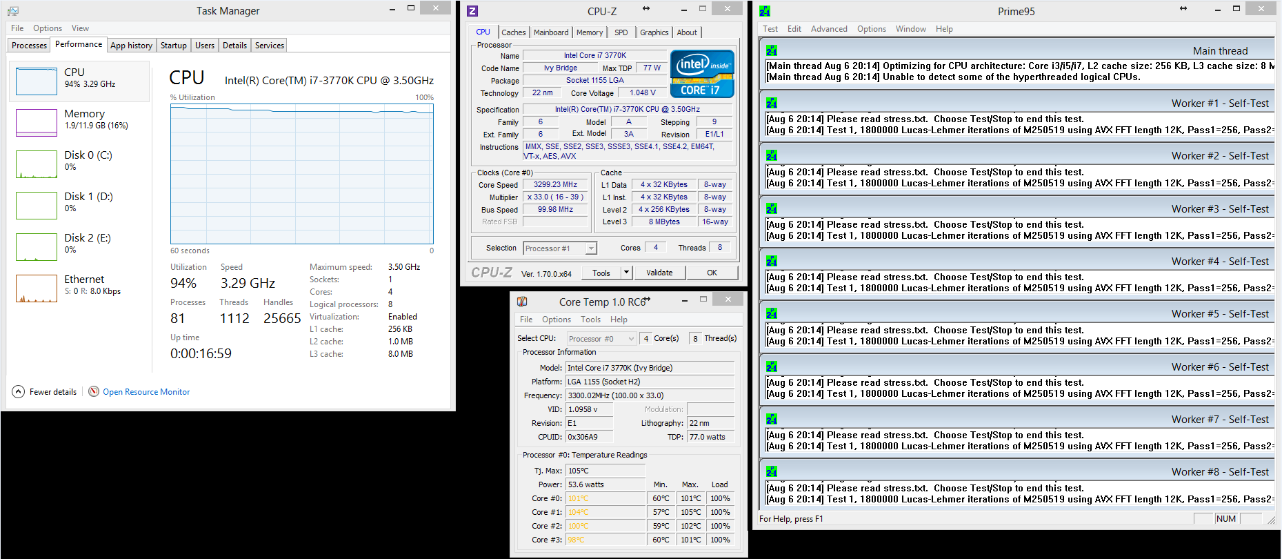

Go to solution Solved by Prokart2000,
I don't hear it running and when I touch the water block itself I feel no vibration.
Could the pump be defective? It makes sense because when I feel the outputs of the fans its not hot at all.
the pump i would say then
So I've came to the conclusion with the help of all of you that my pump doesn't work. I know the H100i is turning on because the LED Corsair light thingy turns on, it's just the pump isn't doing anything. I can't hear it and when I touch the water block itself I don't feel any vibrations; 1 tube is just hot to the touch whilst the other tube is cool which leads me to believe that the water isn't flowing. To prove this I double checked the heat exhaust of the radiator that the fans should be removing. The air is cool, no heat. That just proved that the water isn't flowing.
I'll get a RMA for this as soon as I can.
Thanks.

Okay, I just wanted to check how my CPU Temp is because it's rather hot here in California, so I download Core Temp and I see it's at about 50c idle!
I then checked what the temp is on full load using Prime95 and it's 105c!
It's actually throttling itself because it's getting so hot!
I don't know how this is so hot! I have a Corsair H100i and I haven't changed anything since like June!
Could it be the motherboard? I was planning on having it RMAed because 1 DIMM slot doesn't work so I can't use my full 16GB of ram.
Screenshot

Okay, I just replaced the thermal paste and made sure the pump was mounted correctly.
There is no change.
It's still hitting 105c. I touched both tubes and 1 feels cool and the other is incredibly hot!
I have my fans in a pull configuration if that matters at all.

I think it's something with the H100i itself. I made sure it was all mounted correctly and I re-did the thermal paste.
I've set the CPU to 3.9GHz @ 1.1v and even after re-doing everything the temps are the same. The CPU even throttles itself.
The reason I'm thinking it's the unit itself is because my idle temps are still in the 50's, while under full load its reaching 105.

is the pump working?
Yes, it's connected using SATA, the LED Corsair thingy turns on, and 1 tube feels cool whilst the other feels hot.
can you hear it running or can you feel the vibrations of it
My Setup :P
Skylake: I7-6700|MSI B150 GAMING M3|16GB GSKILL RIPJAWS V|R9 280X (WILL BE 1070)|CRUCIAL MX300 + WD BLACK 1TB
https://linustechtips.com/topic/193372-cpu-temp-105c/#findComment-2622707

can you feel the water moving through the tubes and my pump is only a small vibration so see if you can feel the water moving
Nope, I don't feel anything. I really think the pump isn't working at all and the water is just sitting there because I can feel how hot the outflow tube is and when I try to feel the heat from the exhaust of the fans it's non-existent.
ok then if i was you i would put the stock cooler back on and RMA it dont run it any more at those temps
