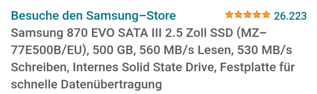

evo 870, ~2 years old, 99% health,  mostly used for recording high bitrate videos (daily). But tbh i always do trim/defrag on all my hard-drives at least once a month. Overprovisioning is off, although I guess Windows does so by itself,  500mb or what?
i mean i know you're trying to help and sure why not, especially trim, but it shouldn't get slow at just 70%?

ok, but i have 7 and this isnt true for any of them?* i mean in my screenshot at 81% its actually faster or at advertised speeds... it definitely didn't get slower, maybe all that trimming paid off?? (we're not gonna mention the dramless Kingston thats like 3mb/s, on a good day! xD)
ps: see? faster than advertised!
994156966_Screenshot_20230129-000559_SamsungInternetBeta.thumb.png.202a6ae354f00a8930e4590a8d8b15d9.png
i gotta say the evo 870 is besides the evo 850 the best ssd i ever had... and its *cheap* too...
the mx500 is pretty good too, but its already at 95% health after just a couple of years~
*jury is out on the 980 nvme though,  dramless, i think its already starting to slow down, most likely will have to refund it soon...
