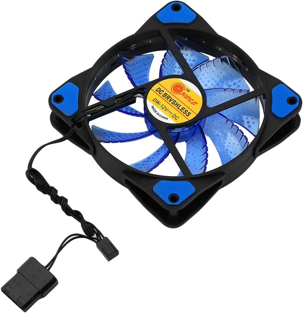

This is my third time around here. With good news. I got my PC to finally boot. I found the culprit. The two front fans were preventing the computer from booting. I had to paper clip method my PSU. I believe I'm hooking them up wrong because I'm a noob at all of this. I got my whole computer together though and working well. Just the fact that the cable management sucks at this moment and none of the sides are on. To give it the best possible airflow. I'm worried about temps though. I get 30c on idle after I've been using it for a while. When I'm playing light games like Minecraft I get around 50c with stuff in the background. I'm only working with the one back fan that goes out and the CPU cooler fan. It still seems to be doing the job, but for how long? It's also winter and freezing so the temperature is cold which is probably helpful too. The thermal paste application was meh because I stuck with the stock one. It was enough to cover the middle, but there is a little bit left to cover. I have thermal paste coming in the mail around next month so I can change it. To troubleshoot it from the start I paper clipped my PSU and took the motherboard out with nothing but the bare minimum. It ran fine and then I put it back into the case and tried again. Then I added the fans and it stopped working again. I had to paperclip the PSU again because of it. I stopped trying to do it because I don't want to risk hurting anything. The back fan was fine to work with because it was the normal 3 pin. The two fans come piggybacked together with this weird connector. image.jpeg.1b33a82eb8ab1db3af1d8e8dbf48a85d.jpeg
I was confused as where to plug them in so I plugged them in piggybacked to the PSU. Basically meaning they were plugged into each other. To me that sounds really stupid now that I think of it. I'll also take any criticism for my stupidity. On the manuals it doesn't show how to plug those fans in, so if anybody could show me how that would be helpful.
It is called Molex. Once upon a time that was our only interface to connect everything except the motherboard and video card to power. Do you want to see something even more weird?

They are the stock case fans. Here is my case: https://www.amazon.com/dp/B07P23M99T?tag=pcpapi-20&linkCode=ogi&th=1 The front two fans are molex apparently. They are plugged into each other and I found a molex connector in the back. So I just plugged it into there and then plugged the fan end into the Cha_2. Every time I do that it refuses to boot and it resets my power supply to where it doesn't work until I paper clip it. Maybe they aren't supposed to be connected together? There is a cord with two molexes that goes to a fan cable. I think I was overloading it by plugging them together in. If you need photos I can provide them.
So if the fans are issue, how were they connected before? Having two powered on single molex is fine. Molex can easily power at least 8-10 fans.
There is a cord from the PSU that has a molex to a molex and then to a fan connector. I went with the best guess and plugged them into one of the molexes. Then I plugged the fan part into the motherboard.
https://linustechtips.com/topic/1296919-fan-issues/#findComment-14415828
Did you try with just the fan part plugged in? You aren't supposed to plug both of those, they are for same purpose. To power fan. If you are unlucky, the mobo headers might have been blown by this misconnection. But other than that, might not have any bad effects since its booting.

The PC is running great. I've been using it for hours with no problems. I've turned it off and on and did updates to see if anything changed and nothing bad has happened. The temps stay on 50c when I'm playing games and listening to music or YouTube. The highest the temps have ever gotten is like straight 60c. I have my stand fan pushing air into the case because there is no intake. The two fans in the front are supposed to be the intake. I haven't OC or messed with any settings because I'm a noob and I'm afraid to blow it up. So it's all on default. This is the best picture I could find of what the PSU cable looks like. Its molex to molex and then to fan connector. The fans connector is two molexes put together. (I believe both fans are plugged into each other). It doesn't have any fan connectors. Amazon.com: Phobya Adapter Cable, 4-Pin Molex to 4-Pin (PWM), 30cm,  Sleeved, Black: Electronics
Thats fan to molex adapter. Its normal that devices which are low power have that kind of breakoff so you can daisy-chain them. I got from the previous reply that fan had also two cables, like:
Am I connecting them wrong? I don't know why fans would cause a computer not to boot. Connections is really the only probably I've had with this build. The CPU, RAM, SSD, and the motherboard have given me no problems with installation. Except the stock cooler because it clicks in and doesn't screw so its finnicky, but I made sure to get it in there as good as I can. I don't know if it would be just easier to buy a new fan with a normal connector or not. I'd only have one fan running at that point, but it would be better than nothing.
Shorting something could be reason for system not booting. So if your fans would have both molex and 3pin/4pin connectors, connecting them both could result as short.circuit.
Do you believe one front fan would be enough? My build isn't a beast and even with the graphics card it won't be. I plan on a 1650 super. I mostly wanna play games like GTA V, Minecraft, CS:GO. Some of the older games. I don't plan to push this PC over the edge, but just some casual stuff.
If you must go with single fan, rear exhaust. If you would have tower cooler, then intake could be fine too. But exhaust is more important than intake.
Thank you! I won't mess with these fans and just buy a new one. The temperature right now is really good and it is able to drop temperatures fast. After closing a game within a few minutes it drops from 50c to 29ish c.
