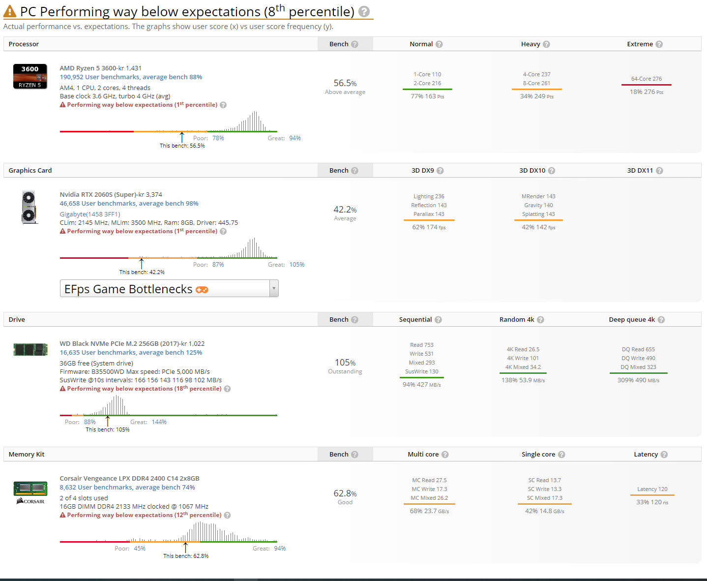

So i recently got a new motherboard, CPU, GPU and PSU. Which is the MSI B450 Gaming Max Pluss, rtx 2060 super windforce, ryzen 5 3600 and an corsair cv 550. When i went to test my performance, i roughly just got above 150 fps on averege. I have seen other people with the excact same build as me and same settings waaay fore FPS. My old build was with the ASUS b250 pluss, i5 7600k and an ASUS ROG STRIX 1060 6gb. Which ran better on CS than it does now for me with my new parts.

That is probably because they have faster memory, because 2400Mhz memory running at 2133Mhz is really not good for a Ryzen 5 3600 CPU.
I would first run a better benchmark, like Cinebench R15 for the CPU and 3DMark for a mix of CPU+GPU and then compare your scores there, since I have never found UserBenchmark to be very reliable.
But I can almost guarantee your memory is the culprit here.

your ram is slow and you're currently not even running it at 2400, but at the default 2133.
make sure you have your two sticks in slots 2 and 4, go into bios and enable xmp. if it boots and work normally, go back to bios and try to increase the ram frequency to 2667 and dram voltage to 1.4. if it boots normally, you might have improved your fps by 10%
