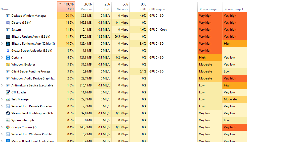

my task manager shows CPU as using 100% utilisation even though nothing i running, it even shows 100% when i first boot it up, i have literally tried everything including updating bios and resetting windows. pls come with some suggestions.
i use i9-9900k and the reason why i clocked it at 3.6 is because i thought it would solve the problem.

Well... what's using the CPU?

In the processes tab, what does it say?
Just now, TheGlenlivet said:
Windows does a BUNCH of stuff when it first boots up that takes CPU power.  This is normal.
AS stated above, I'd check to see what processes are running.
its not only when i boot its always and the things taking up cpu switch randomly

so i reinstalled windows completly cleaned the drives
Your pictures in the previous post show otherwise. Pretty sure Windows doesn't come with Blizzard's software, Gyazo, or Chrome.
I want to know what it's doing on a completely clean slate, before you install stuff on top of it.
so when i first booted after reinstalling windows completly i checked task manager and the cpu was 100% it was showing that task manager was like 50%, and other normally things was weirdly high

Didn't spike to 100% until the last 5-10 minutes. Looks like if was on for 2 days before the cpu usage jumped.
The graph only shows data while it's open, so that screenshot could be of the last 10 seconds or 2 days.
