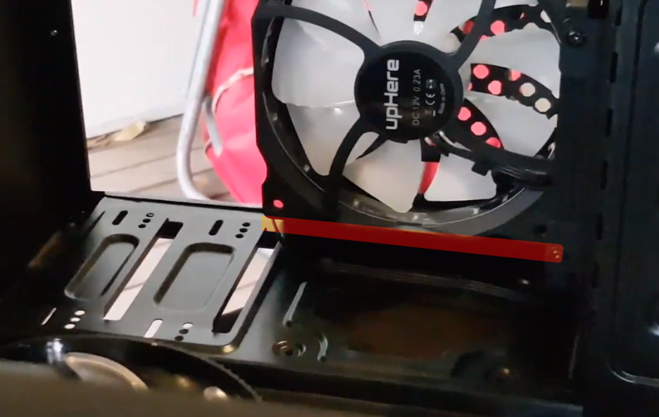

Are you sure? Did you find photos that show that there's enough clearance around the mounting holes for a larger fan frame?
No. So far as I can tell there aren’t any pics. Perhaps “would” should be “could”. The internals could be different from the externals.

Either word would have the same meaning in this case. The word you're looking for is 'might'.
Looking at how close the front fan is to the motherboard tray panel, a round 140mm might press up against it or not fit.
The question seems to be is the drive cage removable or not.  If the drive cage (which she apparently has no actual use for) is removable then yes. Would.  They usually are.  I don’t know though, so only “could”.  Leaving it in place? Almost certainly no.

I was referring to the panel connected to the motherboard tray.
It seems to be the same piece of steel as the motherboard tray but I take your point.
So too narrow not too shallow.  The thing will hold a 5 1/4” drive so it being too narrow is pretty unlikely.  It depends somewhat on the placement of the fan holes themselves. The 5/12” bay connectors seem to be on that plate implying it’s centered with the ones on the other side with 5 1/4” between them.  Still seems like a pretty good bet.  The bottom 5 1/4” bay would be impinged on but it’s also not being used.  I am moving under the assumption that a 140mm fan is narrower than a 5 1/4” drive.  I need to go check that perhaps.
UPDATE: checked. I predict she won’t have a great deal of space on the sides.  I think it will be there though.  Maybe 3mm at the narrowest point, the drive cage will have to be removed (assuming it even can be) and there is a chance that even if it can, there may be a tongue or something sticking out of where the drive cage attached that could cause problems.  The fan will impinge on the lower of the two 5 1/4” bays, but neither of them are being used in this build.  It basically cores the thing out.  No 3.5” spaces, only one 5 1/4” bay available.  If the drive bay is removable and there’s no flange and a 140mm fan that has 120mm mounts is used, I think it will work.  Drive cage is everything though.
