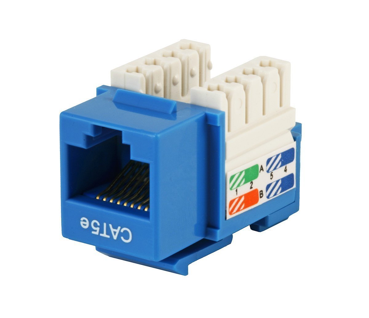

So an ethernet punchdown block looks like the first image below.
What these do is take the bare wires inside of the cat5e cable and pair them so they will work with a regular patch cable.
NOTE: You will probably two labels on them, one that will say T568A, and one for T568B. USE T568B. T568A is an old standard.
After this, you will need a switch. to connect all of your patch cables to your modem. These can be as cheap as $20 if you only need 5 ports, but get more expensive depending on how many ports you need.
You can also use individual connectors for each cable. Those are called keystone connectors. (second image.) You can see the different labeling for T568A and B on the side of this connector as row "A" and row "B" Long story short, line up the 8 small wires with the correct color coding (Blue, White with Blue stripe, Orange, White with Orange stripe, etc) to the "B" layout and you should be good to go.
Please feel free to ask any more questions as you get them. Also if you live in the US, I know for sure there are phone service technicians that also do cat5e networking and could do this for you if you are willing to pay someone and don't want the headache. I'm assuming other countries have the same technicians available.
IMAGE 1

Okay. I'm gonna throw a lot of information at you. Ask as many questions as you need.
IMAGE 1
IMAGE 2
