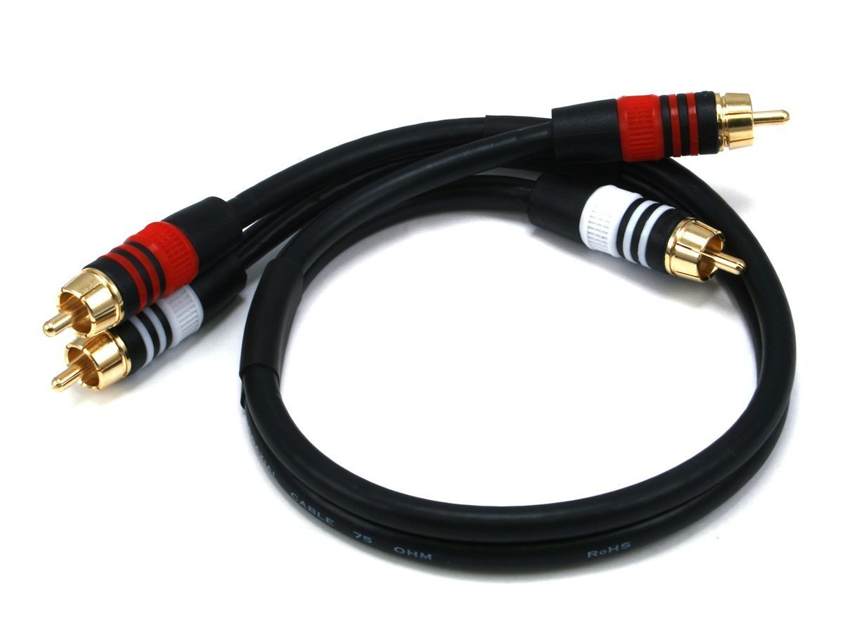

You need to use an RCA to RCA cable for each speaker.
I already told you that RCA to TRS will not work correctly.
Image result for rca to rca cable
One cable goes to one speaker, the other to the other speaker.
Then it will work properly.
