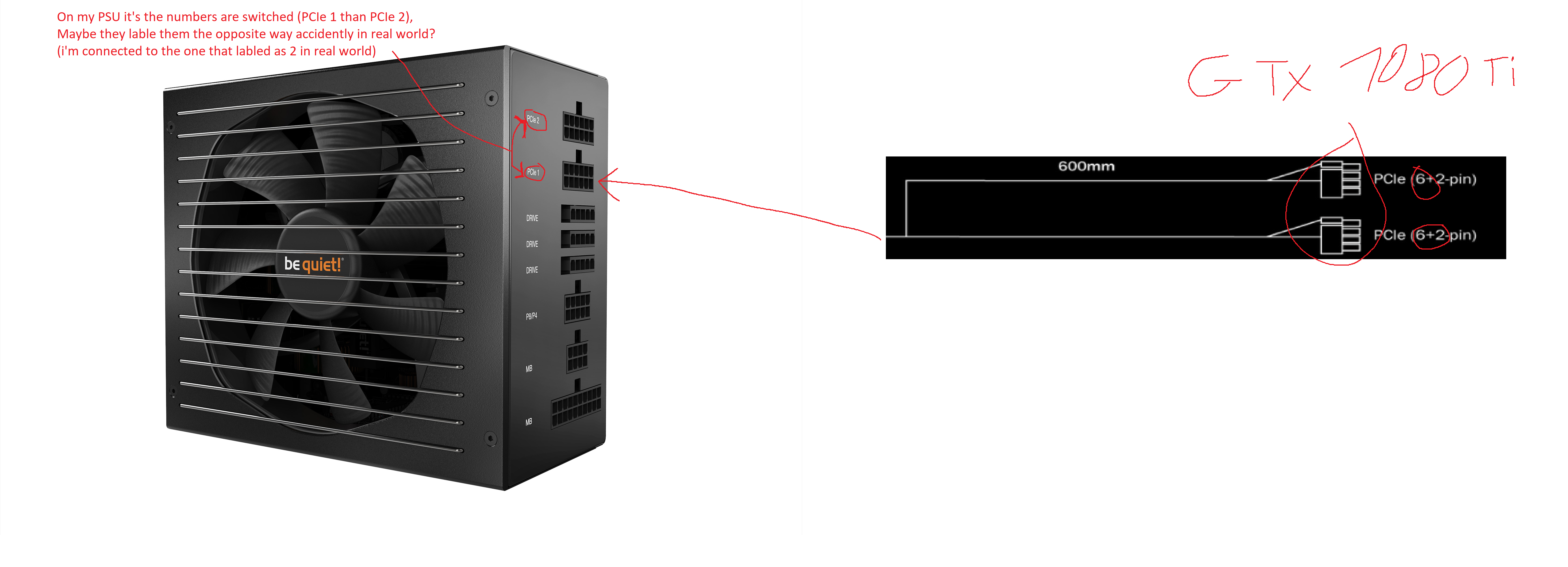

PSU MAYBE?
First of all, I don't know what PSU rail mean and i'm not PSU expert.
This is what I saw on the Overwatch forums...
Can it actually be the case?
This is how things looks like in my PC:
This is what they said in the document:
I'm connected to PCIe 2 (as they said on the line that I marked).
What do they mean "Please make sure you Balance the load across the 12 volt rails 12V3 and 12V4"?
Maybe the "PCIe 1" and "PCIe 2" labeled incorrectly on my product?
