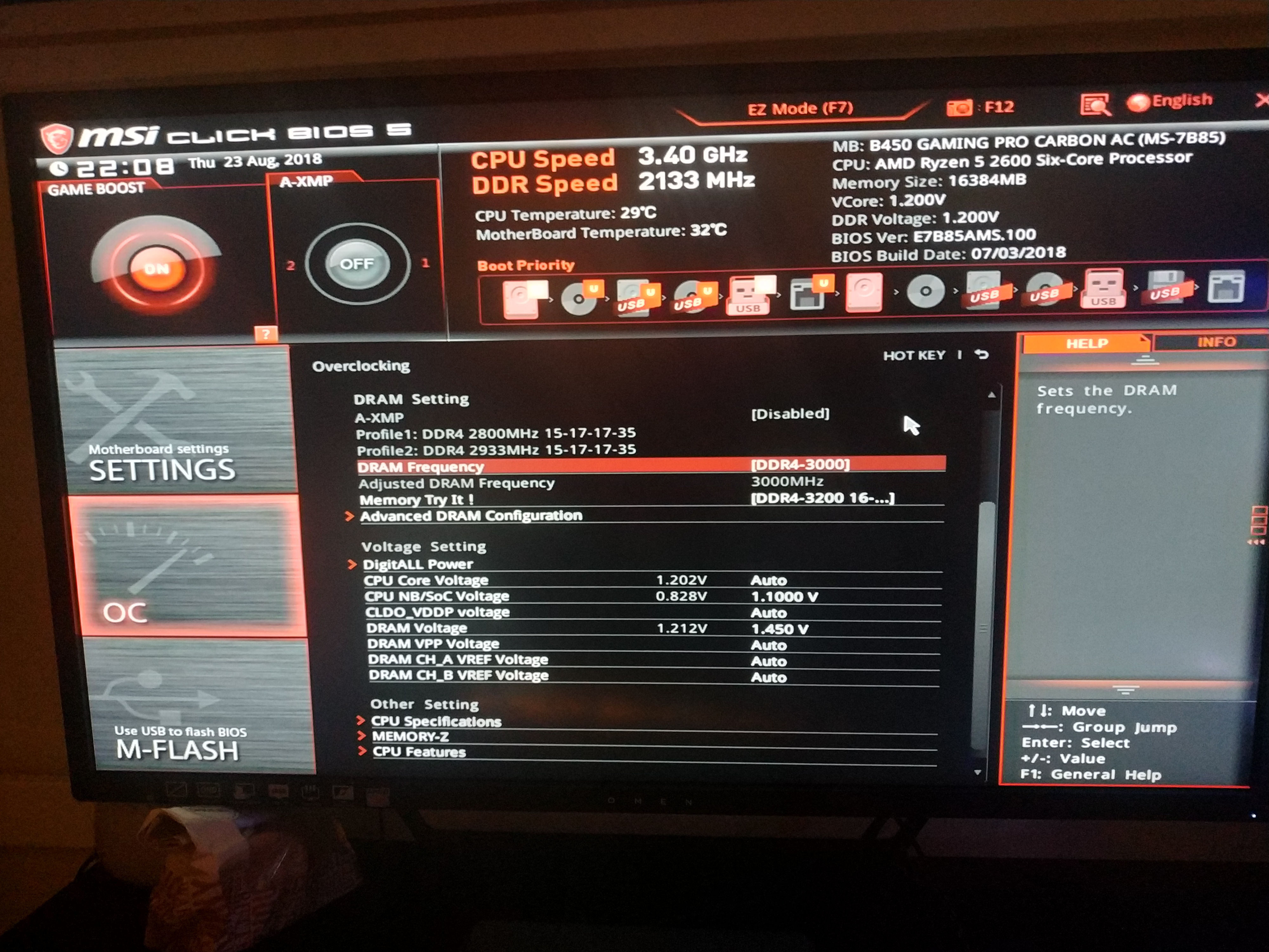

9 minutes ago, nick name said:
@SupersonicSaint One thing you may have to do in conjunction with Try It is set your voltages. The faster speeds and tighter timings generally need more DRAM voltage. So a lot of XMP profiles are set to 1.35V. Feel free to go all the way up to 1.45V according to what AMD calls safe and many people go as high as 1.5V. SOC voltage you will want to bump to 1.1V and probably leave there. That is also an AMD recommendation.
Is this okay? I noticed at the top it says "DDR Speed 2133 MHz". Also, how do I "Run memtest in the UEFI mode to check the stability and boot into windows"
I imagine if it says 2133MHz it probably is. You likely didn't save or apply any changes you made. And you probably won't need DRAM voltage of 1.45V at the speeds you're going to start at, but you can go up to 1.45V as needed as you progress in your overclock.
With your CPU overclock it's pretty straight forward. Increase CPU multiplier and increase CORE voltage. You don't want to be above 1.4V on your CORE voltage. Ideally you always want to find the lowest voltages that will allow you to run stable. You may need to set a Load Line Calibration, but you want to avoid the highest level of the LLC. So if it goes up to a level 5 then use level 4.

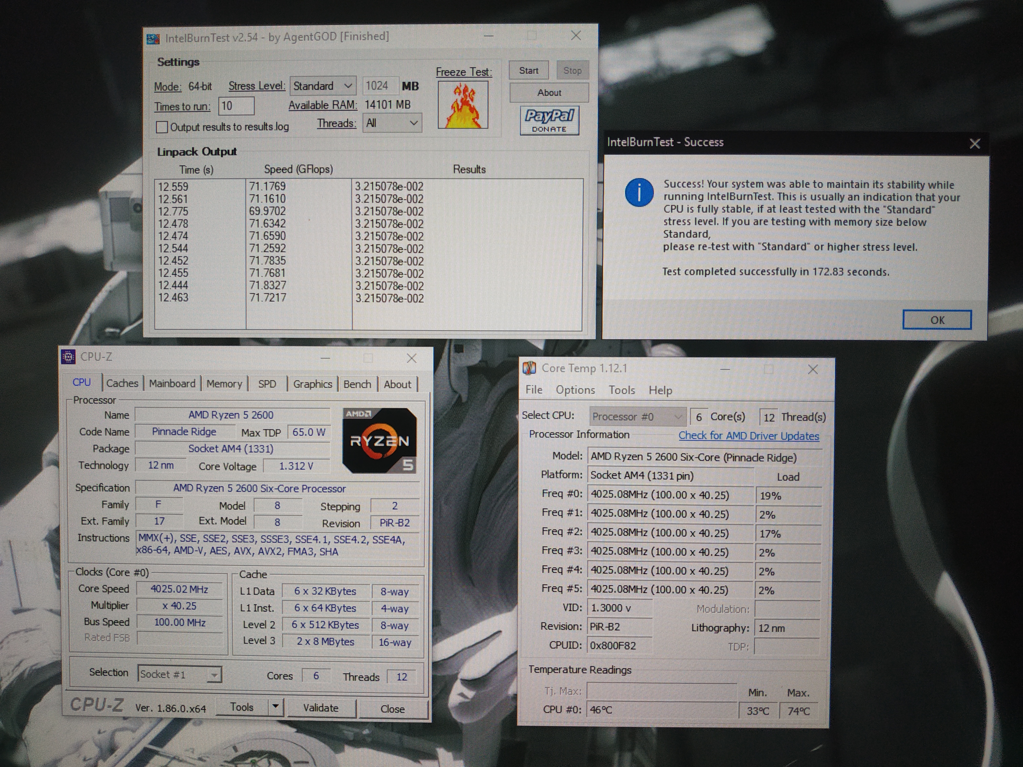

1 hour ago, nick name said:
Ayyy that seems pretty good. What are you using to stress test your CPU to check stability?
After more stress testing I decided to put it down to 4.025 MHz at 1.3 V. I used Intel Burn Test for stressing. I also overclocked my RAM to 3200 MHz and stress tested with Ryzen Master Memory Stress Test. My 1070 Ti is that one Gigabyte overclocked version they accidentally released when they weren't supposed to so I don't need to worry about overclocking that further or my PC will get even more loud haha.
https://linustechtips.com/topic/963895-overclocking-ram/#findComment-11679092
Try Prime95 as well. It's a test you can leave running. Use the Small FFTs for testing your CPU and Blend Tests for RAM testing.
True RAM testing requires a test that will run overnight. A lot of people use HCI MemTest. You will want to look up how to best utilize that one. Also something like memtest64. Really something that you can run for an extended period and that can use as much of your RAM during the testing as possible. That is why some folks will test their RAM outside of the OS.

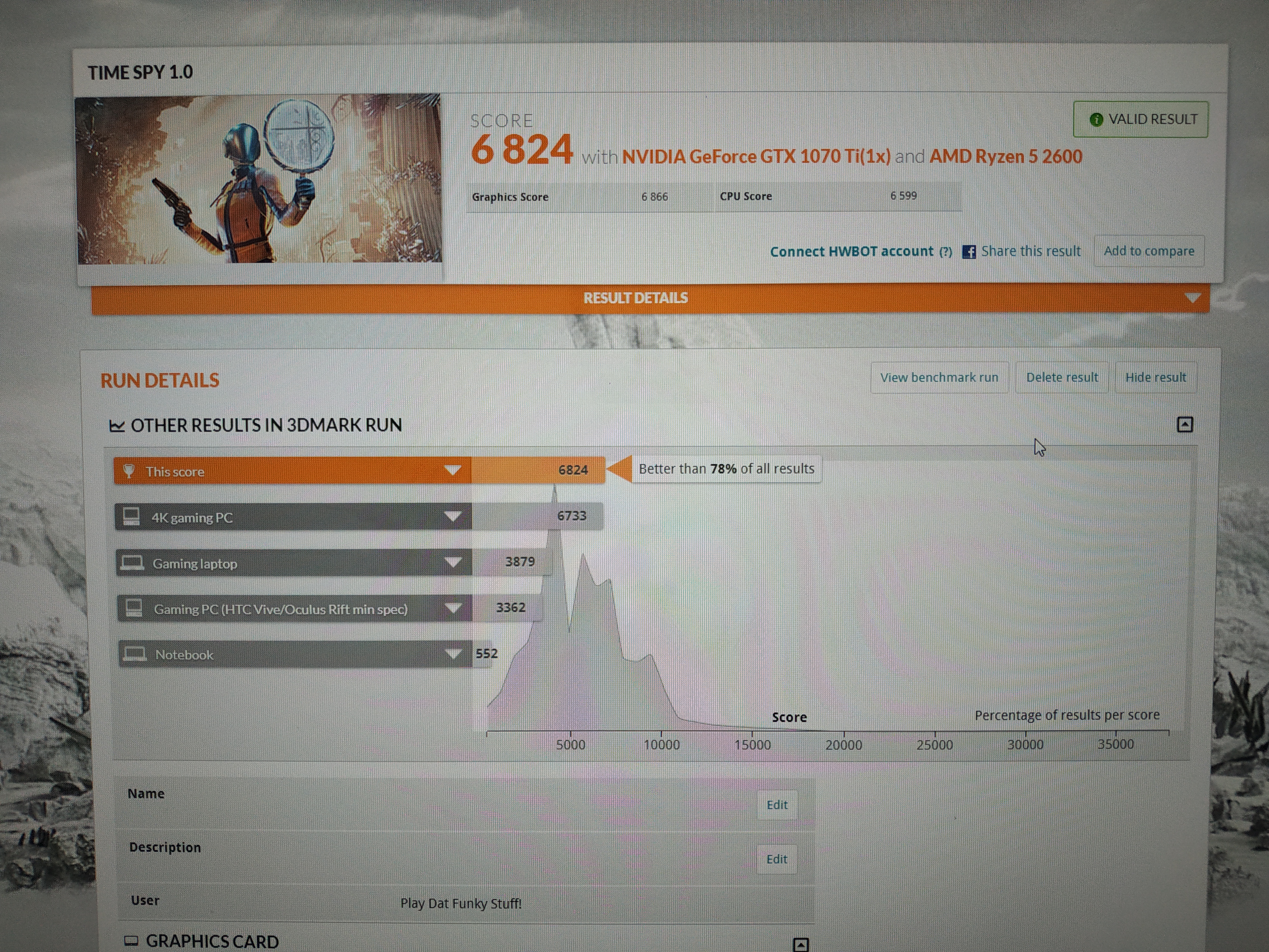

IMG_20180824_020103.thumb.jpg.741d6321b55e59e0e2709a2fb266f2d0.jpgI just ran 3DMark twice. Does it not suffice?
https://linustechtips.com/topic/963895-overclocking-ram/#findComment-11679272
Not if you really want to test your stability. Short runs of anything are good indicators that you're fine, but unless you want to find out the hard way during an intense gaming session or something important you want to at least those things I recommended.
Different applications require different power amounts. You may find that you don't have sufficient voltage for either your CPU or your RAM. You can run the Prime95 Small FFTs test while browsing the web. Monitor your temps as you do with something like HWiFO and make sure none of the workers in the test have stopped due to an error. And then run a memory testing application overnight.
None of this is mandatory but they are best practices.
