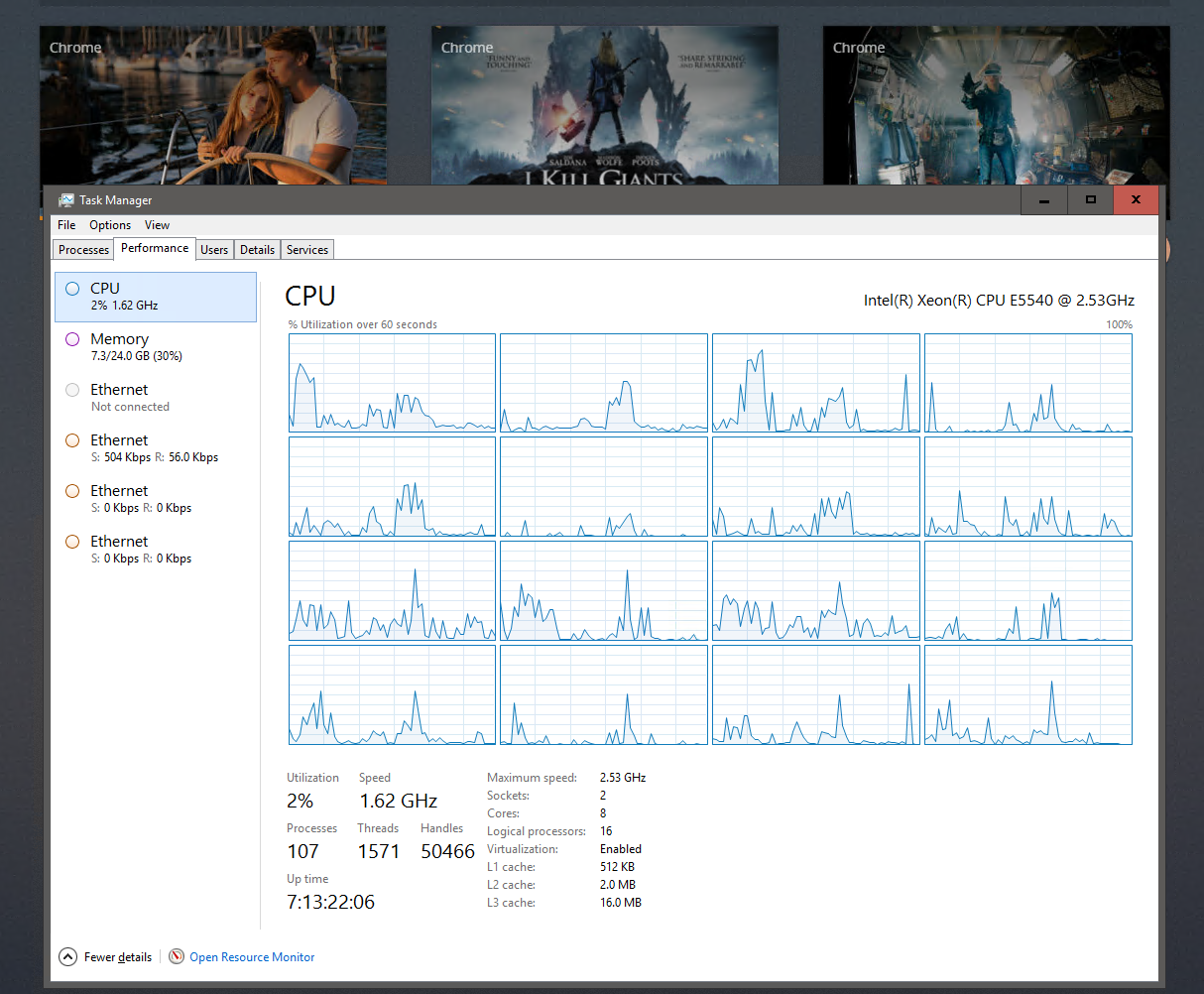

This is 3 x 1080p DTS 5.1 streams (10Mbps) with 2 x E5540 CPU's.
