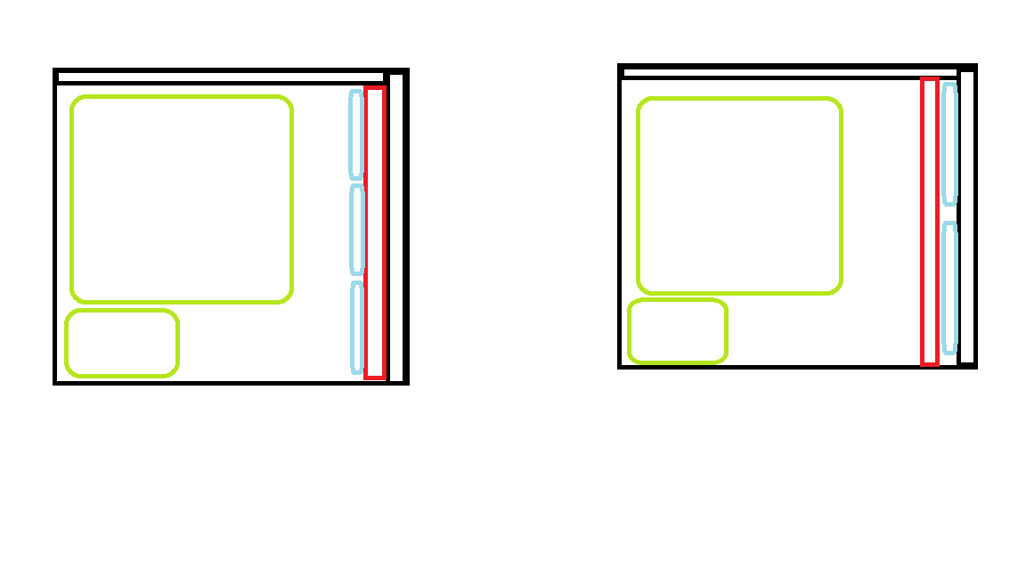

the Idea was to fill all the available space in the front with RGB fans on the radiator. 3 seems to be good but I don't know if I can do that with a 280 mm radiator. I think only 2x fans, and don't know if they will fill the space. Never mounted an AIO before, only traditional air coolers so... Don't want to buy a thing so that when I start to mount it it won't fit or not be able to do what I want.
Like on this quickly made picture...
Black: the case
Red: the radiator
Blue: the fans
Green: PSU and MoBo
Please point me on the right direction.

Your case does not support more than 2 fans in the front of the case. These can be 2x120mm fans, or 2x140mm fans.
Quote
  • 2 x 120/140mm Front Fan
  • 1 x 120 Rear Fan (Pre-installed)
  • 2 x 120mm Bottom Fan
  • 1 x 280mm Front Radiator
  • 1 x 120mm Rear Radiator
  • CPU Heatsink Compatible
    - CPU die surface to side panel height: 156mm Maximum
https://www.in-win.com/en/gaming-chassis/805#product_spec

ok will try a corsair 280mm (like a 110i or a 115i) and change the radiator fans with 2x corsair LL140 RGB fans.
thanks by the way :)
