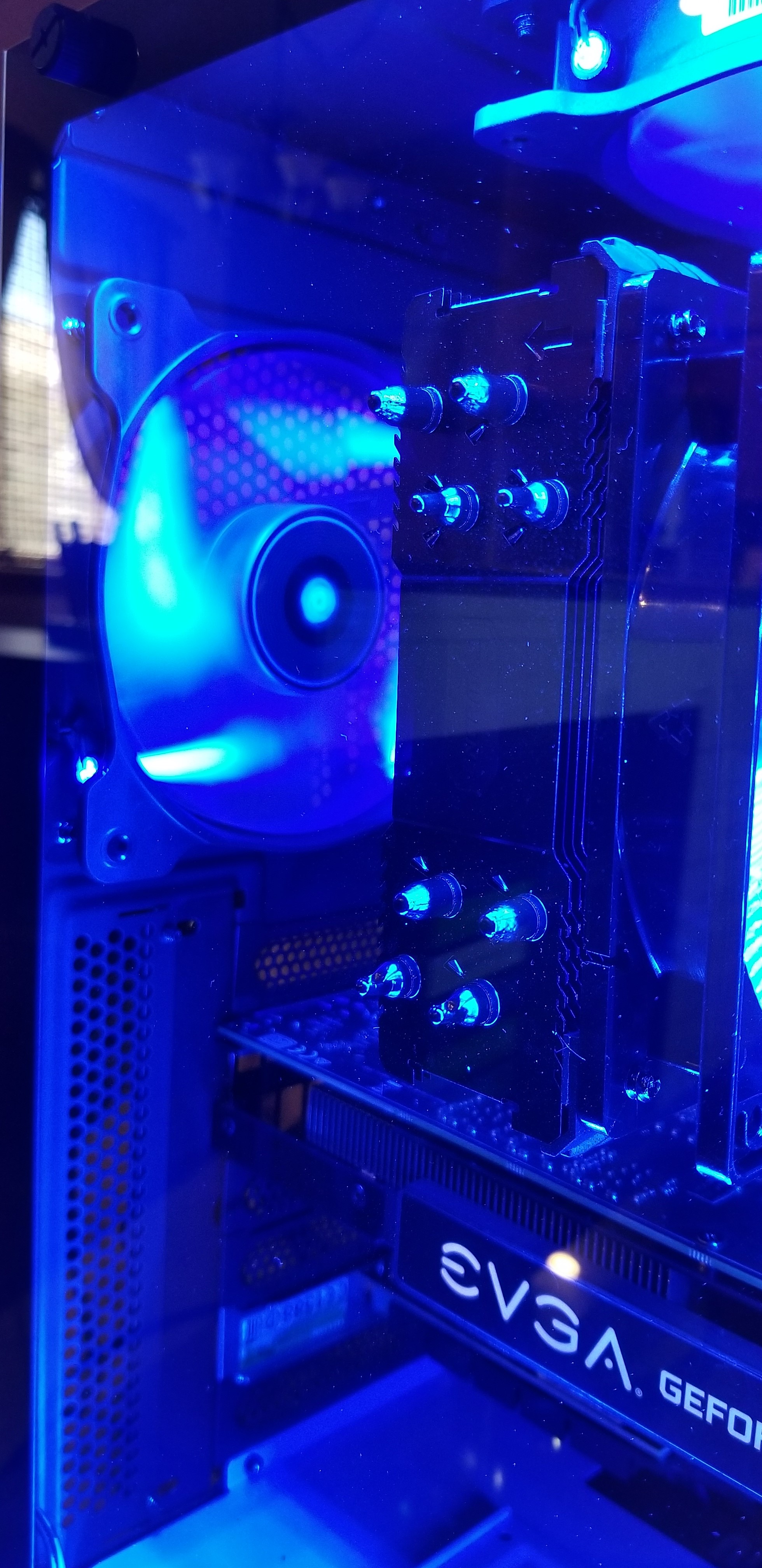

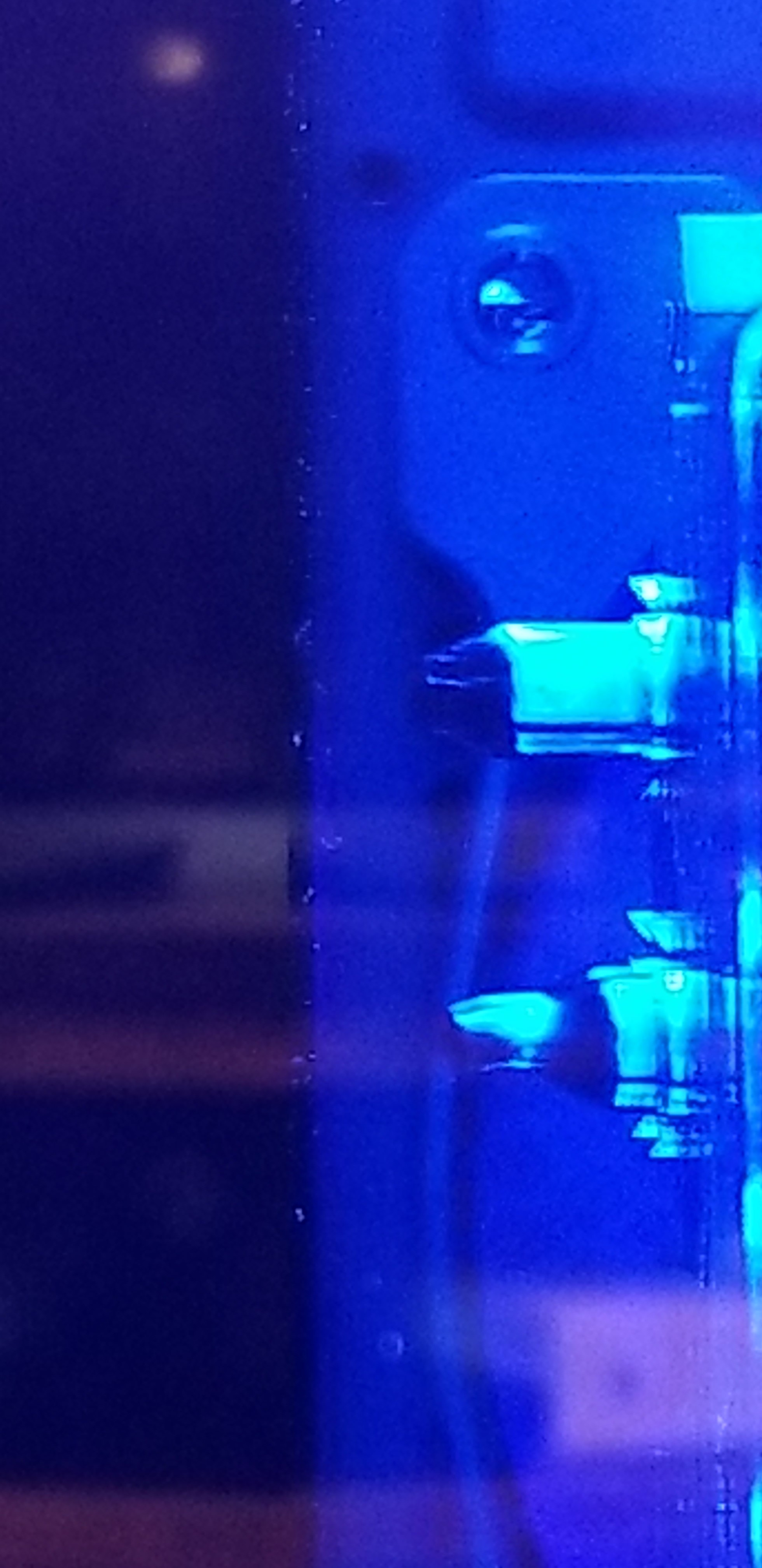

The height limit according to Cryprig's website is due to the fans, not the cooler, so its possible to mount the fans slightly lower and save a few mm, which is possibly how he did it. That or the 165mm number is conservative. From my experience this is not usually the case, as in my Blye Build I used a 161.7mm cooler in the S340 Elite which lists 161mm cooler height, and the heat pipes were basically touching the glass
