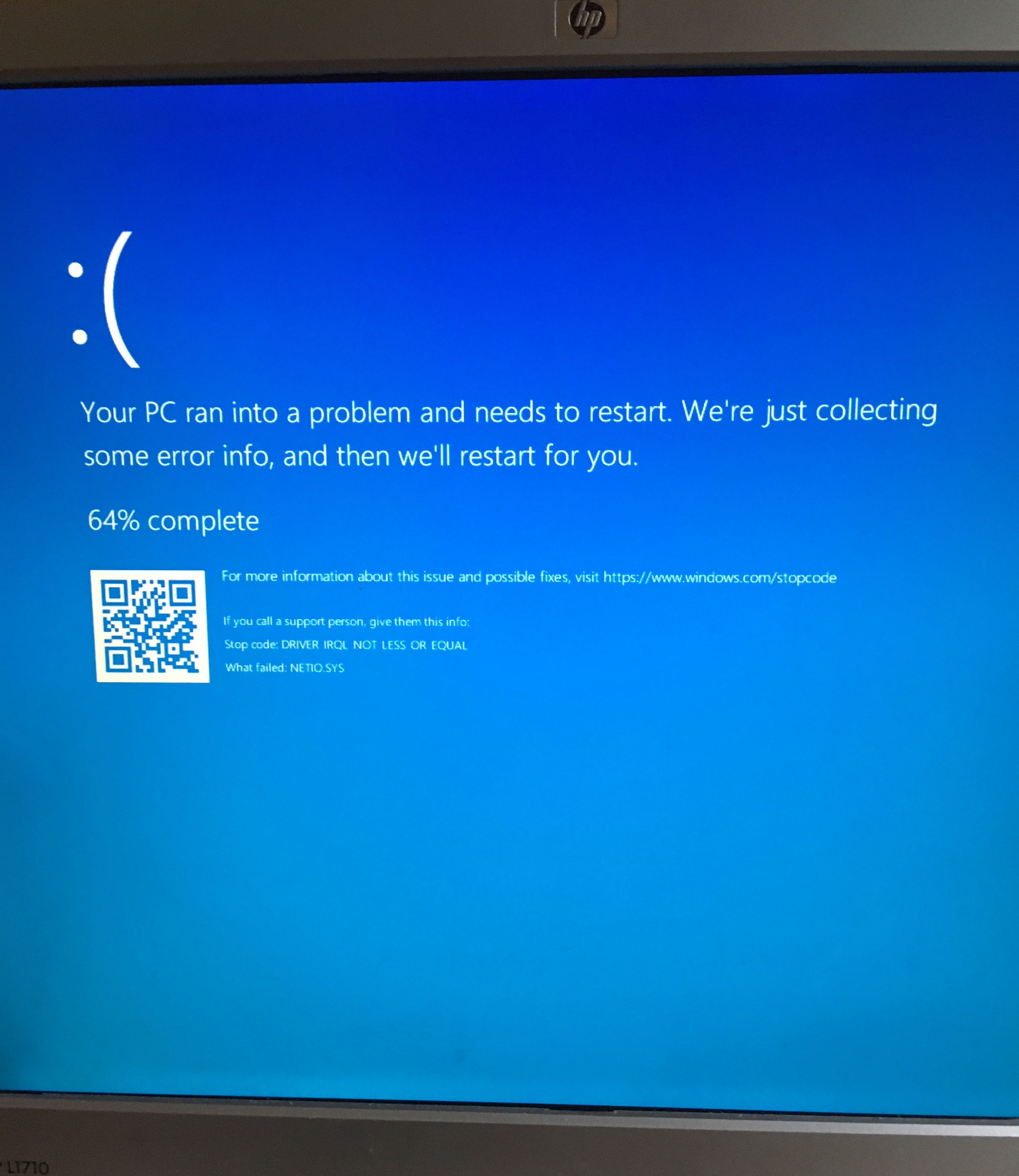

I was trying to use my pc and all of a sudden it bluescreened. It was right after I just installed the Nvidia Drivers but I got rid of those quickly before it bluescreened again. It still bluescreens and I can't even use my computer. My pc works in safe mod so its an issue with drivers, also because the error code says something about drivers. I can't do the specific steps including opening command prompt and typing "perfmon /report" because it opens up and then says something along the lines of "Unknown location" or similar. For some reason, probably because safe mod disables the drivers, I cannot use the internet while in safe mode. I only was able to get the dump files and a screenshot. Although Baidu said something about "Autorun.inf" or something like that and I was able to remove that in safe mode but still bluescreened when booting into normal mode. I have Windows 10 64 bit, Windows 10 was originally installed. I have had to reinstall it for odd reasons like videos in Adobe Media Encoder weren't rendering but that fixed the issue. I completely reinstalled it this time because before I couldn't install nay windows updates. The os is a full retail version, The age of the system of me using it is 6 months. But the hardware is a few years old or a year. (EVGA GTX 1070 SC, i5-7500, Ballistix 8GB 2400mhz DDR4), OS is a couple of months old but I just yesterday reinstalled it because I though it might fix the issue. I've reinstalled it 3 times since of got the pc for various issues, CPU model is an i5-7500, Video card is a EVGA Geforce GTX 1070 SC, Motherboard is a Gigabyte GA-B250M-DS3H, Power supply is a EVGA Supernova G1 120-G1-0650-XR 80+ Gold 650w Fully Modular Power supply, There is no system manufacturer because I built it. No model number because I built it, it is a desktop. All of the parts are new except for the video card which was used for a few months but it wasn't bitcoin mined on. The dump files will be in a link right here because it is a zip file ---> http://www.mediafire.com/file/4x67jw8e4ms2gxq/Dump Files.zip

This sounds like bad RAM. Grab a copy of memtest86 and see what it has to say. Posting the dump here isn't too helpful without having a copy of the Windows debugging tools and a bit of special sauce.
I'm going to assume you're running a clean, otherwise unadulterated install of 10. No tweaks or silly patches, just a clean install of 10 and your drivers.
DRIVER_IRQL_LESS_THAN_OR_NOT_EQUAL boils down to two possible options:
  • The driver in question is poorly designed (in this case, it's netio.sys that's failing. I'm going to rule this one out for now)
  • a chunk of memory has gone wonky and is causing corruption, leading to the driver trying to access memory it shouldn't (this is much, much more likely and the cause of 90% of these)
Easy test is to run your system with only one stick. Repeat with each stick until you can determine that it isn't that stick. If no sticks will boot cleanly, then there might be an issue with your motherboard -- Reset your BIOS settings to default would be my suggestion.

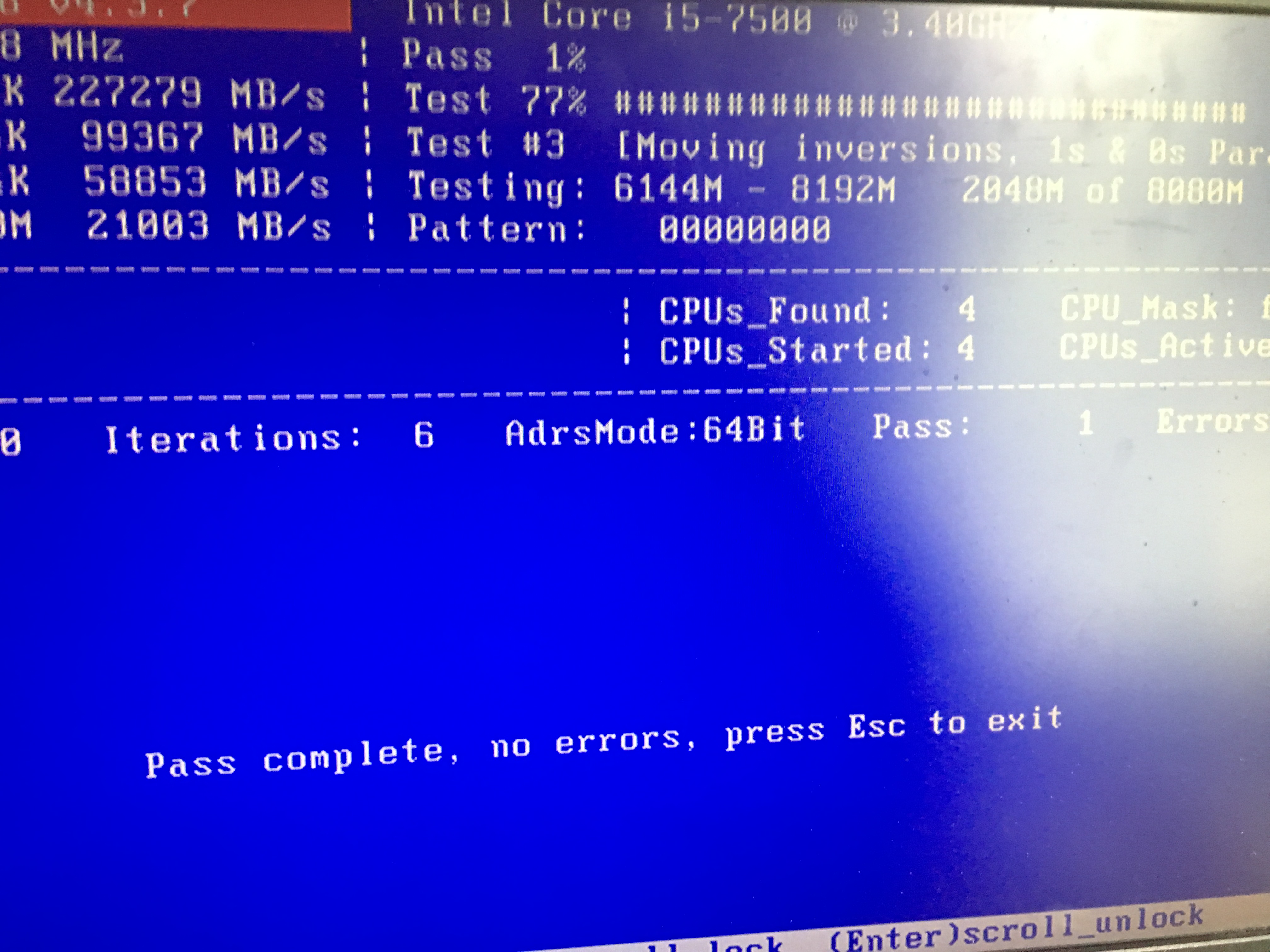

I also tested Windows memory diagnostics and nothing came up.

Nevermind. I found the issue.
NETIO.sys
From another thread on the matter:
There appears to be a program installed that may be causing problems with your network connectivity and may be contributing to the BSOD with the netio.sys.
That program is the NVIDIA Network Access Manager program.
The NVIDIA Network Access Manager is an optional program that may be offered during the installation of NVIDIA network adapter drivers.  You can decline the invitation to install the NVIDIA Network Access Manager during any installation of NVIDIA adapter drivers, if it is offered.
The NVIDIA Network Access Manager software is not necessary and has been known to cause issues.
For now I would suggest to uninstall the NVIDIA Network Access Manager program using "Uninstall a program".
Then restart the computer and check the situation in the Device Manager concerning the Microsoft Teredo Tunneling Adapter which is presently disabled.
So it's nVidia driver related, but not video card, but rather network. See if you can uninstall that part...
