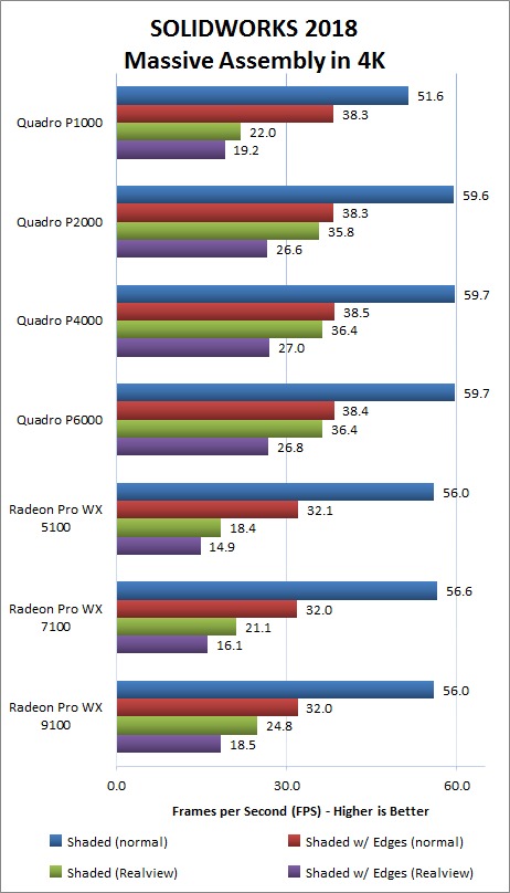

According to Puget systems which do tons of testing to see which configurations are ideal for different programs, when it comes to SolidWorks, it doesn't really seem to matter:
pic_disp.php?id=46302
As for Inventor, they haven't provided a chart for some reason but they had this to say on the subject:
Quote
In general, a Quadro P2000 5GB is great for small assemblies, while a Quadro P4000 8GB will be better for medium assemblies. If you work with very large assemblies, you may even consider a Quadro P5000 16GB.
Considering you found yourself almost getting by already with just a 750 Ti, I have a feeling even the P2000 would do you fine, but the P4000 would certainly be excellent for the job.
Quote
And yes, the P4000 has ~4x the SP and DP performance of the 750 Ti.  5,304 GFLOPS vs 1,372 GFLOPS for SP, and 1/32 of that for DP in both cases.
