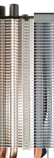

On 7/8/2019 at 6:27 AM, WoodenMarker said:
Thanks a lot! I've noticed that from some coolers, (ie. ID Cooling SE-214X vs. ID SE-214RGB or Fera 3 vs. Fera 3 RGB) there are options for RGB unit, usually more expensive. Is there any difference in REAL PERFORMANCE? As far as I am aware of, the Fera3 RGB is actually a different cooler, a less tall design, below 145mm, whereas the standard Fera3 is roughly 159.
The 214X vs. 214 RGB seems different as well, at least, the latter is far dearer. Is it solely for the lighting, or there is difference between heatpipes&sinks&fans as well?
Sorry for asking, I 'm just generally curious. :)
The rgb options are often not the same cooler or fan but just in rgb. In the cases of the SE-214 RGB and Fera 3, the fans has more blades which results in higher airflow and noise as stated in the specs.
At least in the case of the Fera 3 / RGB, they have a similar number of fins and seem to perform similarly.
Fera 3 (left), Fera 3 RGB (right)

They aren't as popular as some other examples though such as the Hyper 212 BE and RGB BE where it's pretty consistently shown that the RGB version performs better.
https://gnd-tech.com/2018/10/cooler-master-hyper-212-black-edition-review/
Keep in mind that the fan change is a lot more dramatic in the case of the Hyper 212 BE / RGB going from 5 wide blades to 10 thinner ones.
I'm not sure about the SE-214 RGB since I haven't found performance results. They're probably still pretty similar though with the RGB variant being a bit better as indicated by the specs.
