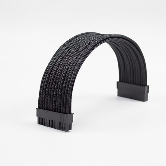

3 minutes ago, mopishcross17 said:
Thanks for all the help but one more thing would pccg or mwave offer theses by anychance? cause i am living in australia
For a plug and go solution lots out there, they come in different colors also:
https://www.pccasegear.com/products/40242/cablemod-basic-modflex-cable-extension-kit-black-6-2pin
