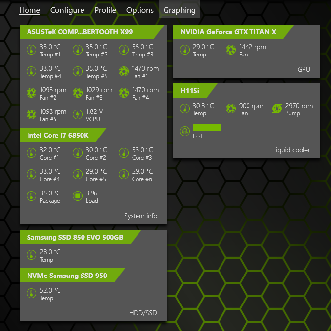

I have a Sabertooth X99 with a i7 6850K in it.
When I built it, I put a Samsung 950 Pro 512GB in the M.2 slot.  Its working fine, but the temps get rather high fairly quickly.
Does anyone make a small fan to fit over that thing? Or a heatsink that'll fit under the Asus 'TUF Armor' piece to help keep this toasty little bastard under some sort of temperature control?  I find I'm hitting the thermal throttle limit somewhat often when running multiple VMs.
The SSD idles around 52 C, and I've seen it hit 75 or 76 C with ATTO quite often.
