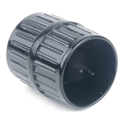

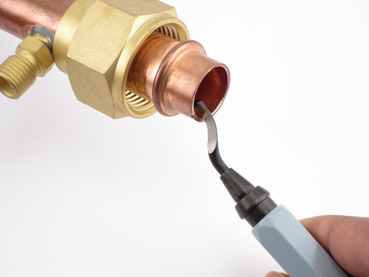

Ever consider using a pipe reamer or deburring tool?
General Tools & Instruments 482 Swivel Head Deburring Tool with Metal Handle (also amazon)
Wolverine PST085 Inner/Outer Reamer (Amazon)
Not sure how well they would work on a rigid plastic pipe but it should in theory work. Also if your using sandpaper on a tube make sure you clean it out very well as the grit can ruin your pump.
I tried both of those on my PETG (since I use them at work) and they were both very... not smooth.  I found a step bit works great for reaming the PETG
