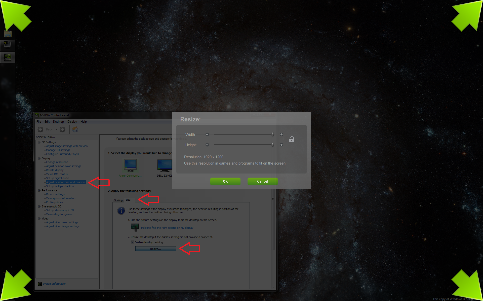

Check for a setting on the TV first, you need to set scan setting to something like "just scan" or "1:1", it's called different things on different TVs. By default it's probably set to "wide", " zoom", or "16:9".
You don't need to touch any settings on your computer itself unless the TV doesn't have any option to change that, settings on the PC should only be used as a last resort in this situation, as fixing it from the computer side will result in a loss of quality.

To fix from computer if you really need to:
I've done something similar to that in Nvidia Control panel cos i didn't see it. But then it messed up the aspect ratio and resolution (despite my TV being 16:9 and my normal monitors being 16:9).
You should be able to go into the control panel for your graphics card and set the scaling for the TV.
I found that for me it didn't work. Or at least very well.

So I have the exact same issue with my r9 380x , my tv is cutting off the edges. I can't access advanced settings on the tv unless I use vga I believe but I'm using hdmi. Not sure if there's an amd control panel or something?
Thanks
